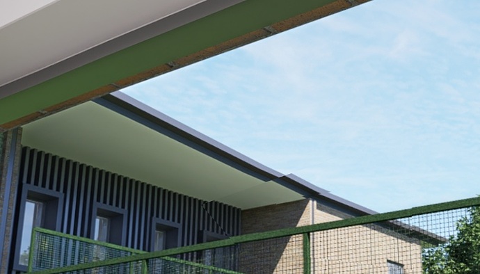

I have been playing with the 3D tour functionality for use in VR. An issue I am experiencing is with alignment of geometry in the view. Is there a setting I can change to reduce or eliminate this? I have uploaded an example of the sort of thing that I commonly see while using VR in the 3D tour.

I apologize for the inconvenience. Does this particular issue only occur with this specific file? Does updating your drivers or your VR Drivers (if there is) improve the distortion?

I noticed that I had sky movement on. I disabled it and re uploaded the outdoor scenes. This helped a little but didn’t fix it. Some of the glitches were far worse than my screenshot.
So I tried starting again. I re rendered and uploaded all the images with the sky movement off and it has fixed the issue. There are some minor misalignments on the occasional door frame but I can live with that.
