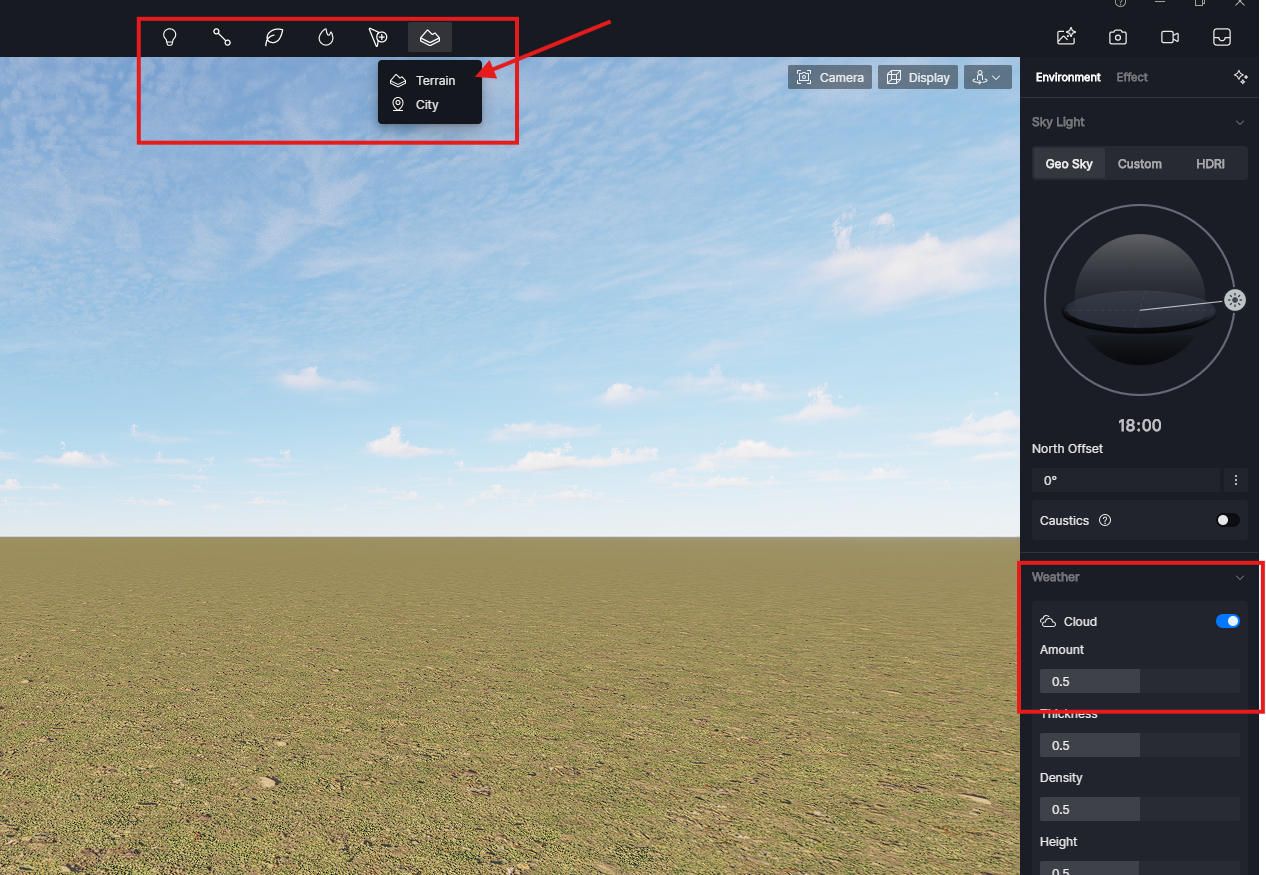

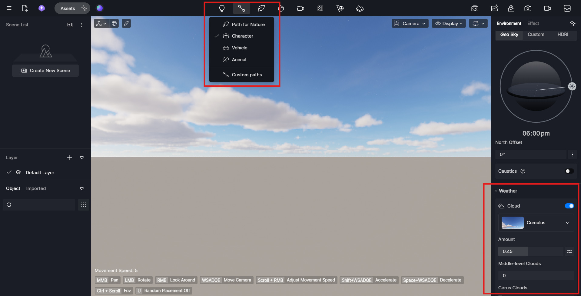

The features you mentioned are fully rolled out in D5 Render 3.0, and you should be able to see them in the UI if the update is applied correctly. I’ll attach a reference below showing where these features should appear.
Could you please confirm the exact D5 version number?
And also, a screenshot of your viewport UI, especially the Environment panel and Path Tool area

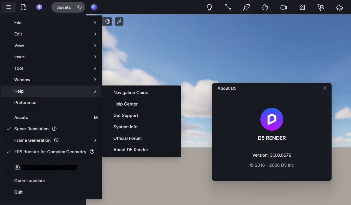

Hi Ela, thank you for your reply.
My version is the same as yours; I’ve attached a screenshot.

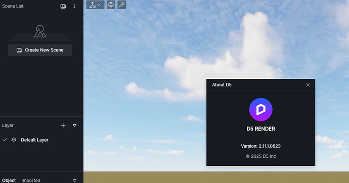

As you can see in the other image, I don’t have volumetric clouds, the Ocean feature, correct displacement, or any of the other new features.
Thank you for your help.

Strange, actually in the Launcher it shows version 3.0.0, as can also be seen in the screenshot of my previous reply, but if I go to Help → About D5 it shows version 2.11.
I performed the update through the Launcher window. So should I update via the website instead? If so, could you please send me the link to download the latest version? Because when I go to the download page Download | D5 Render, I can only download the D5 Launcher and the various plugins.
