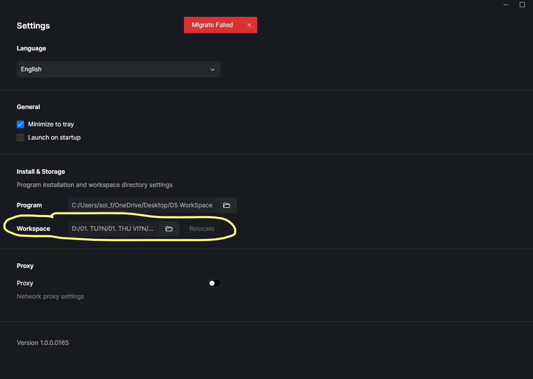

Hello everyone, I wonder if anyone has encountered a situation like mine where I cannot change the workspace location in the install & storage section. I have two computers, and both are experiencing this issue. On one computer, I can click the change location icon, but when I press the relocate button, the location reverts back to the original position. On the other computer, I can’t even select the change location icon. I hope someone in the community can help me. Thank you everyone.

Hi @3Dquin
This issue was caused by the launcher version itself; no matter which file path is being assigned, it still shows the error before, and now it has already been fixed.
  • How about your launcher version? You may want to redownload it from our official website just to ensure that you’re running the latest one.
  • Do you have full folder control of your Documents section? Please check.
  • Does having it assigned to another location still have this error? Or only to this specific path?
Hi Clov,
Thanks, it works now.
