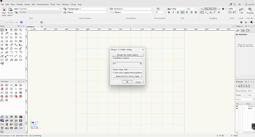

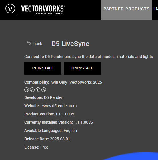

I am having a version mismatch with the D5 livesync plugin inside Vectorworks. I am using VWX 2025 Update 7 and installed LiveSync plugin version 1.1.1.0035. However, the plugin inside vwx is showing 1.1.1.0024
Screenshot 2025-08-27 125812
I have used the installer from these forums, as well as the installer built into Vectorworks, and they both give me version mismatches. Also, when I use the installer inside vectorworks, it shows that 1.1.1.0035 is installed, but the plugin within the program still says 1.1.1.0024.

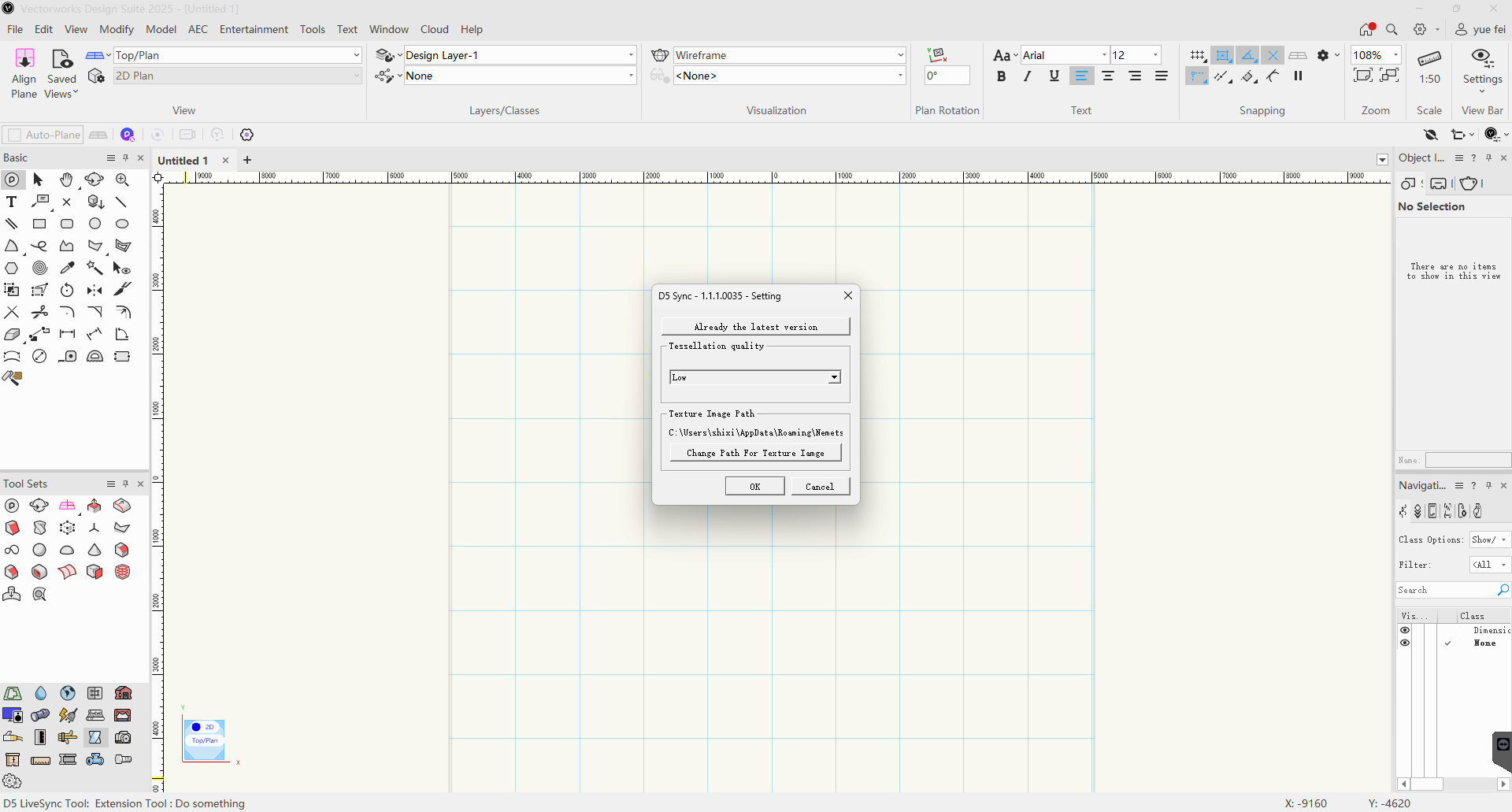

Hi @wellebracht
I tried it on my end, and it shows the latest version of the plug-in that I just recently installed.

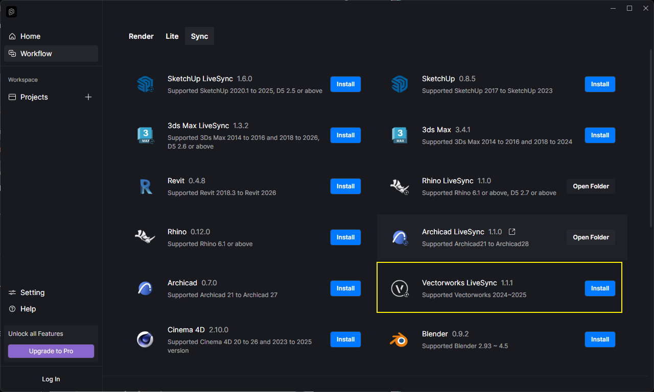

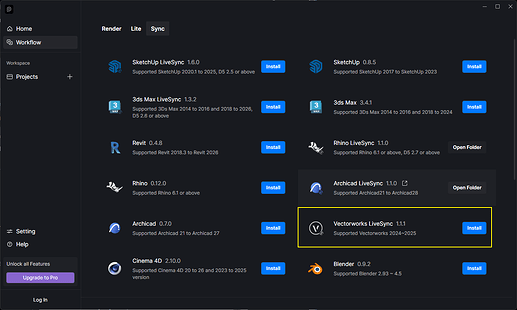

  • Try completely uninstalling this plug-in so you can cleanly reinstall a new one.
  • You may also try installing it via the D5 Launcher
I uninstalled all instances of LiveSync and tried installing it through the launcher, but still get the same issue. I even uninstalled VWX and reinstalled but the plugin is always showing 1.1.1.0024 for me

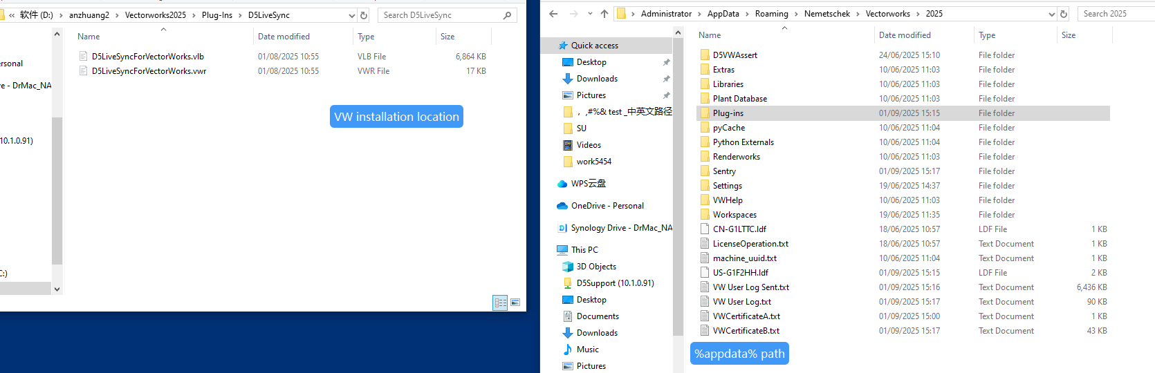

Please check if there is a D5LiveSyncForVectorWorks.vlb in this file path:
  • Delete it if there is, then reinstall it.
  • We tried installing VWX 2025 Update 7 on our end, and the Livesync Plug-in information is correct.
Please let us know of the results.
