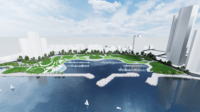

there is some issue with ur scene, is there any complex model or reflection applied. stuck at calculating.
oh… ithink it might take quite alot for calculation
any specific reason
i think too many assets also the big scales make it hard to calculate, what is your spec for your computer?
i have rtx 3090 , i’ll optimize file 2moro for fast render.
oookay thank you again
found it, surrounding buildings have reflection which is not that necessary for scene
ohh that was the reason…, sorry im a bit new to d5
