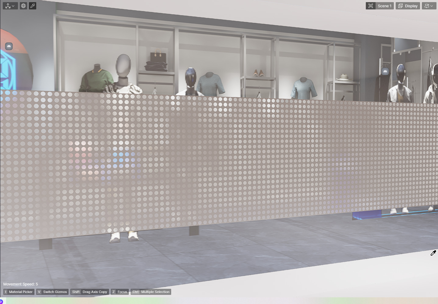

Another method is to convert your PNG Photo to DXF Format, then insert it into your 3D modelling software and apply it to the specific surface. For reference, I am using SketchUp and I ensured that the materials are different on the parts where it is fully transparent and frosted. This way I can assign different materials on these surfaces.
After enabling Livesync I assigned Frosted Glass on its surrounding material and Normal Glass in the logo.

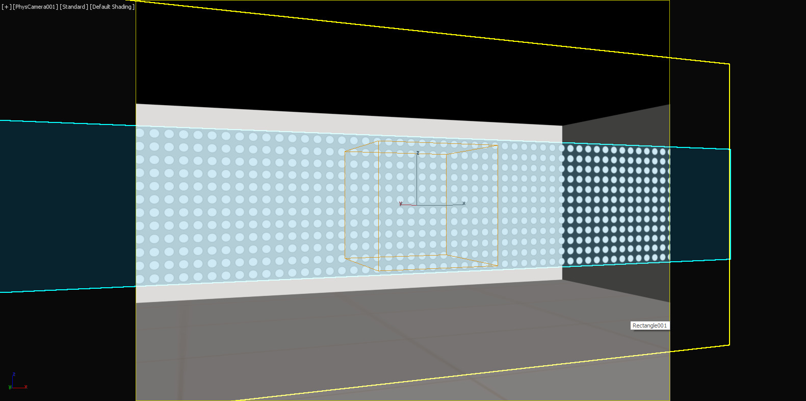

actual scene in 3dsmax glass base model and texture plane over glass.
frost material applied on texture and inverted, dot got frosted but outside black part also remain in white shade. its shloud be get opaque .
