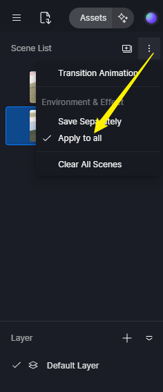

Hi @alexandrecollaco
For environment and effect parameters, if you wish to apply the changes to all of your scenes, please enable “Apply to All”

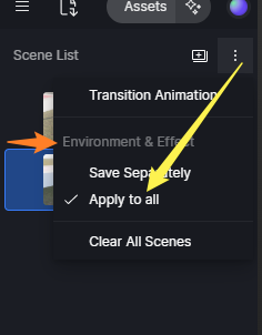

This is usually applied to the Environment and Effect parameters only.
