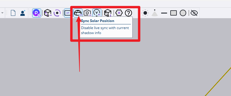

Hi @kss
If you have the latest version, you should have this icon “Sync Solar Position”
Yes, I have seen the button, but it did nothing.

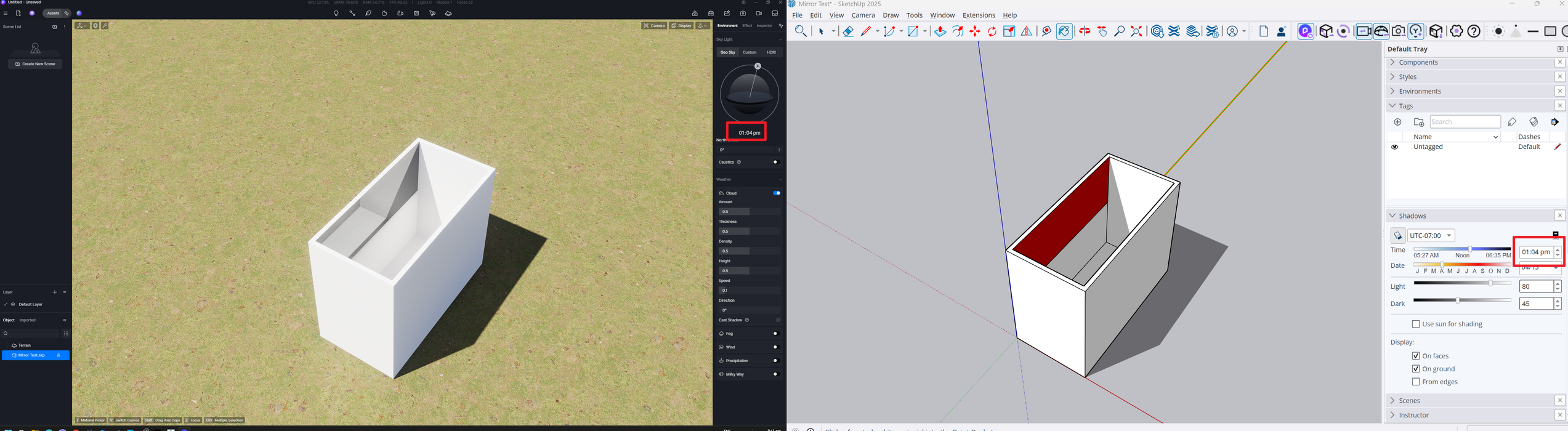

However - I think I found the cause. I need to have the shadows checkmarked in SketchUp. I never do, because it makes working in SketcUp terribly slow, even with a very decent graphics card.
