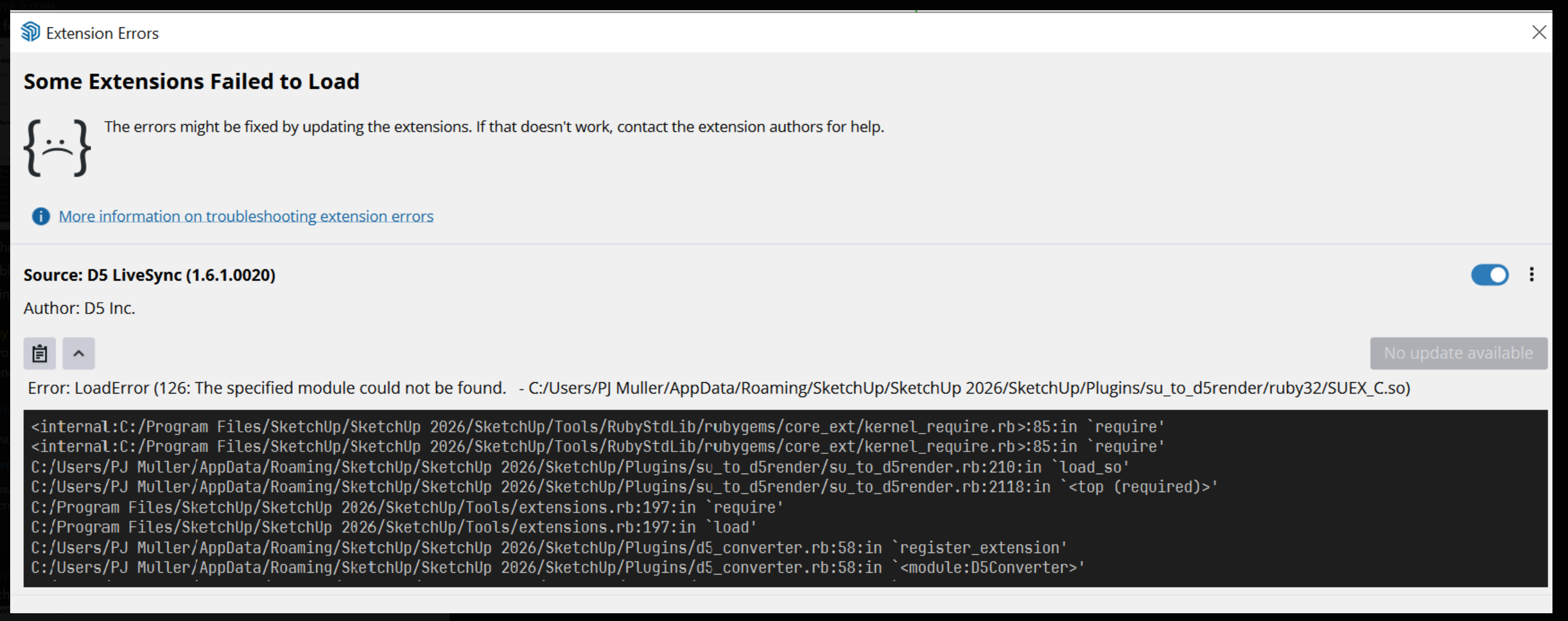

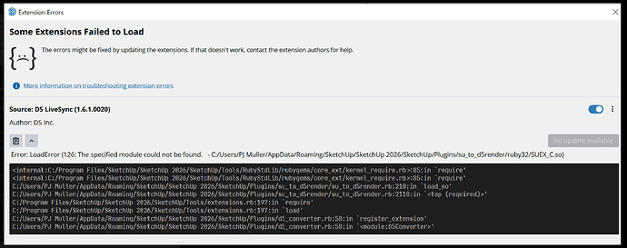

Hi - I installed the most recent version but now I get the following message when sketchup opens: Load Error (126: The specified module could not be found. SUEX_C.so) That SUEX file is present in the correct folder. Any suggestions how to fix this?
Hi @pjmuller
Could you please send us a screenshot of the exact error message you’re seeing in SketchUp? That will help us diagnose the issue more accurately.
Also, did this same error occur when you were using the previous version, or did it only start appearing after installing the most recent update? Thanks!
Hi - It was working fine in the previous version.
I also posted this problem on the D5 discord. (305) Discord | “Do we know when LiveSync for SketchUp 2025 will be available?” | D5 Render
Hi @pjmuller
Sorry for the inconvenience. We are still reviewing your case. It appears to be a unique situation, and our team is carefully checking all the details you’ve provided. We will update you as soon as possible once we have more information. Thank you for your patience. :face_holding_back_tears:

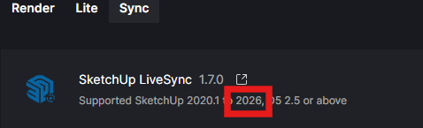

Hi, I tried installing LiveSync for SketchUp 2026 directly from D5 Workflow Sync section but the latest version shown here is SketchUp 2025, although it says on the description the it supports SU2026. It’s not showing here though. Screenshots attached below.
What could possibly be the problem and where can I install LiveSynce for SketchUp2026?
Thank you!
Hi @tashi1
Thank you for sharing the screenshot. This LiveSync version itself should support SketchUp 2026. To help us pinpoint the issue, could you confirm the following:
  1. Which D5 Render version and Launcher version are you running?
  2. After installing the plugin, did you restart SketchUp 2026?
If the issue persists, please try a clean reinstallation and download Livesync from our official website. D5 for SketchUp Real-time Rendering Workflow
I look forward to your response.
