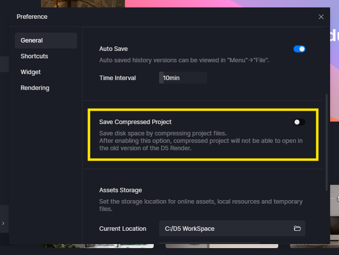

i d like to know to save projet with increment.d5 save everything and all the folder become very heavy! Can i juste save the d5 file and not all the folder when i make increment of my project please?
Hi @neoseb
Currently, D5 creates a folder for each file and deleting the other components inside will make the file malfunction, so I don’t recommend doing it.
- You may try enabling this feature.
Thanks.it’s really better !

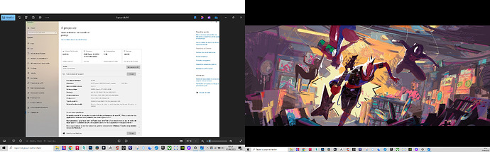

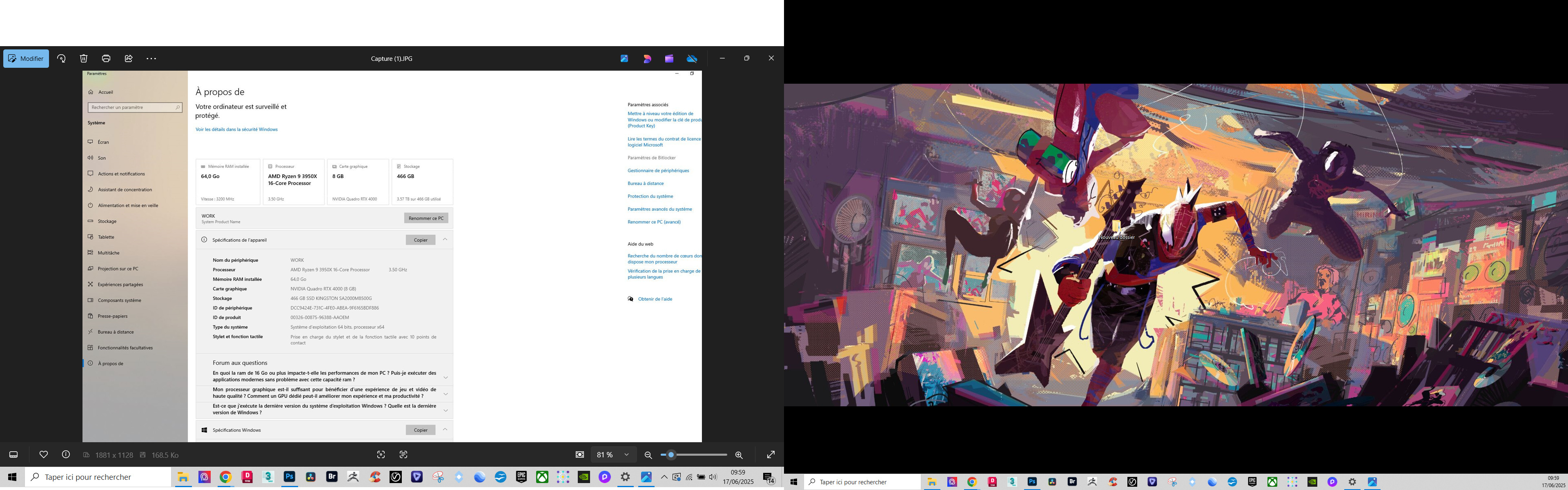

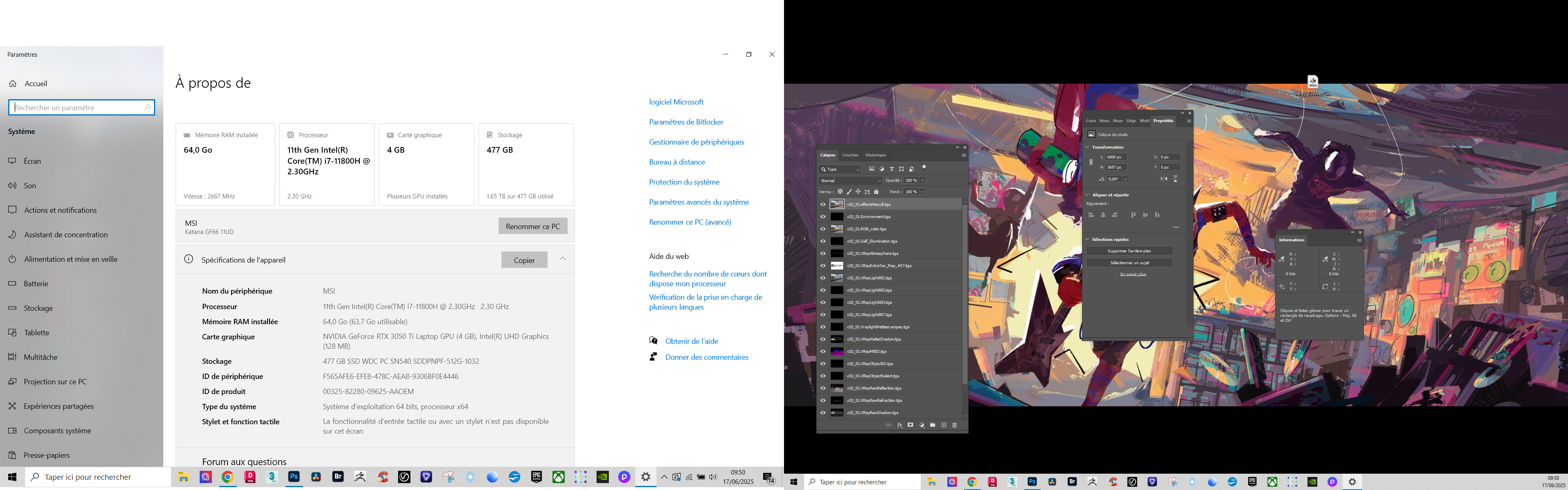

thanks for your feed back.I didnt see your message.The strange thing i could open the file on my labtop less powerfull…
Hi @neoseb
Can you share to us the system information of the other device and your laptop? You may refer to the screenshots that I have provided above.
- If there is a significant gap between these two devices, then that is indeed abnormal, considering that the file can’t be opened on a powerful device and can be accessed using a less powerful one. You may want to consider updating your Graphics Card Version to a newer version and see if there are any differences.
where i can open it
and this my biggest computer…where i cant open it…But in true i m going to make soon an animation where i m going to increment much more project;)

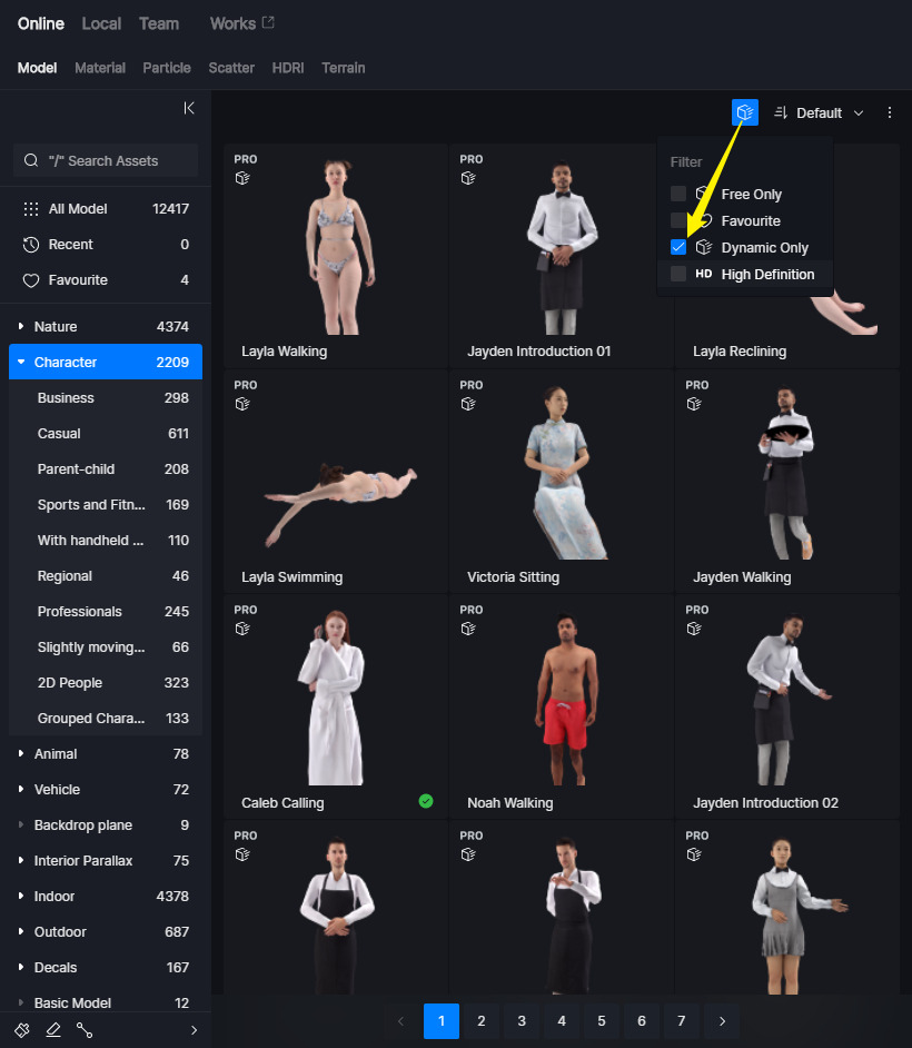

Other question i asked:is that possible to know wich people is animated in the library without download it?Thanks in advance

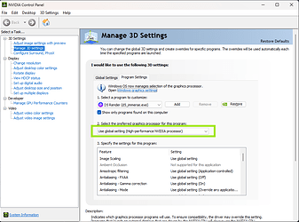

Can you check your Computer’s Task Manager, specifically this portion and try to open your D5 file or perhaps a Demo Scene file?
VRAM Info - Open you file or a D5 file, just to check if D5 is utilizing your device’s RTX GPU
You can also try modifying the NVIDIA Control Panel
Yes it’s possible to filter out characters that are dynamic.
