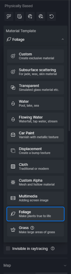

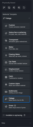

SSS, Displacement and Clearcoat(Carpaint) doesnt seem to work from the Rhino Physically Based material. It would be good to have this integration.
Folliage . Couldn’t find a way to create a foliage like translucent material in Rhino.
This is a problem. Partially compensated by the amazing plant library from D5 but it would impede to have custom plants and also courtain materials straight from Rhino.
As a bootstrap suggestion: What if the name of the material in Rhino has a tag like “leaf” (ex. Monstera deliciosa leaf), and then D5 interpret it as a leaf material, would also work for the carpaint and SSS.

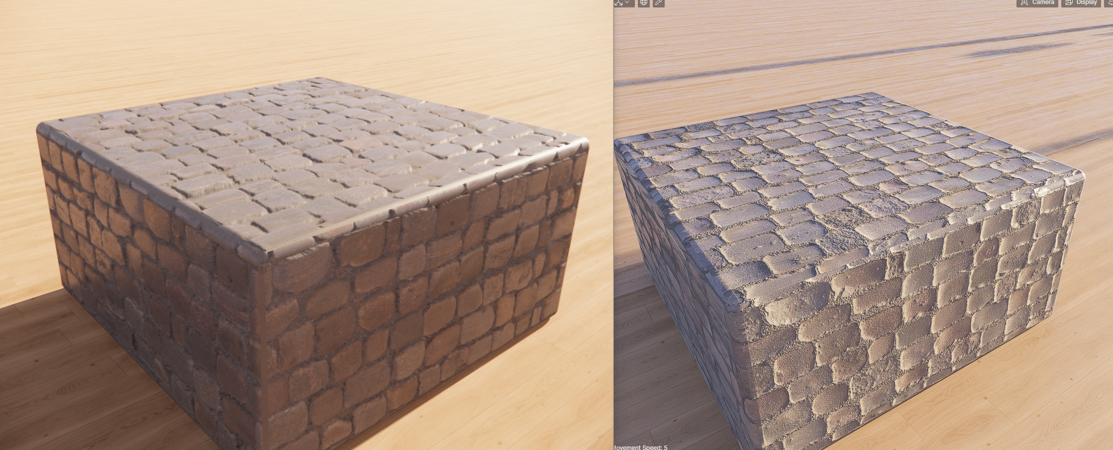

- Displacement. Could not figure out how this works in D5, it looks like a very cheap solution. Bellow is a comparisson from displacement in Enscape(left) and D5(right).
