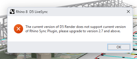

I tried to LiveSync my project but it keeps giving me the same error i also checked versions multiple times even though versions matches keep saying same thing. Also reinstalled all again and again. Please help me

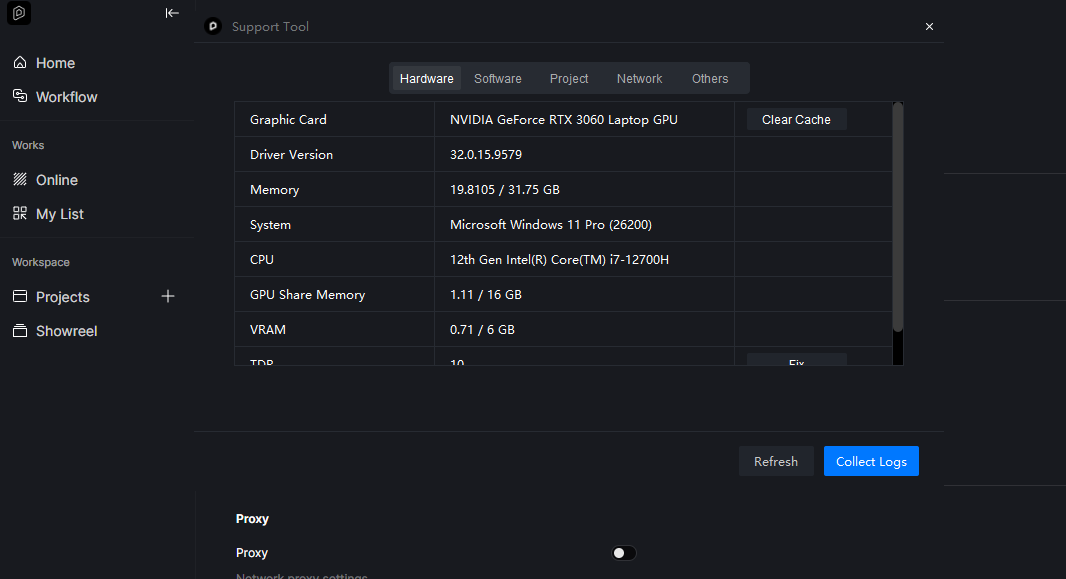

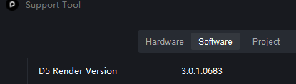

Use the directory indicated there to locate the config.ini file, then check the D5 version specified inside the config.ini.
