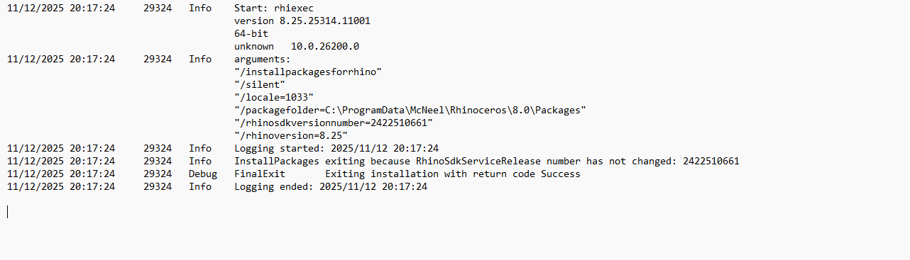

This is the log file after crash, If it helps
If I uninstall Rhino d5 liv sync plugin , all works

When I directly open Rhino as a blank template file it crashes, it happens with all files. No error report is generated. It only shuts down without any warnings. The prevision version I got (1.1.0.0002) and its working normally.
