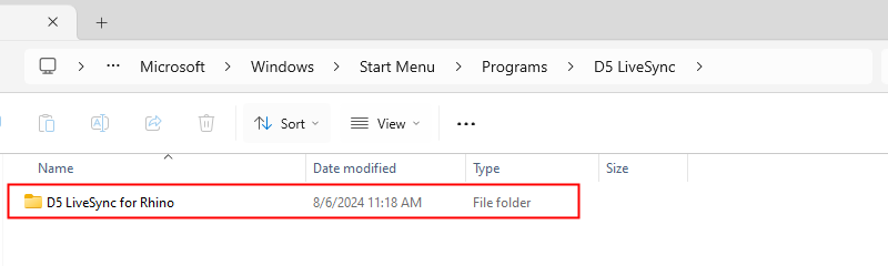

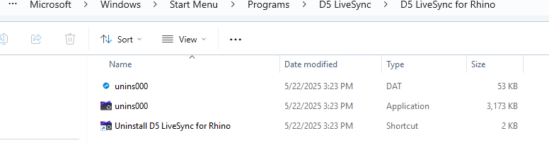

I’ve tried uninstalling and reinstalling twice. The install shows in my programs list but in the install location there is just a series of unistall files and there is nothing that shows up in the Rhino plugin folder or in the plug-in install list.

In these folders, for both Sync and LiveSync plugins I have only uninstall “things”. It seems there is no body of the plugin itself.

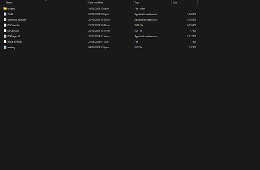

The D5 LiveSync folder inside the Plug-in folder in Rhino should contain the following files:

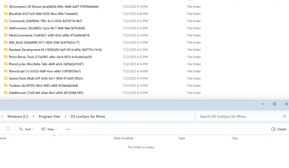

Both McNeel Plugin floder and D5 LiveSync for Rhino are empty.
