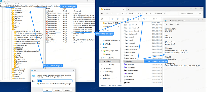

  1. After installing Render, the content will be written under the corresponding path of the registry
  • Path: HKEY_CURRENT_USER\Software\Microsoft\Windows\CurrentVersion\Uninstall\D5 Render\DisplayIcon
  1. Find the config.ini according to the directory pointed to in【Step 1】
  2. Open this config.ini to view the render-version
  3. Edit the .ini file. If it shows older than 3.0.1 the user should edit it to 3.0.1 if they are using 3.0.1

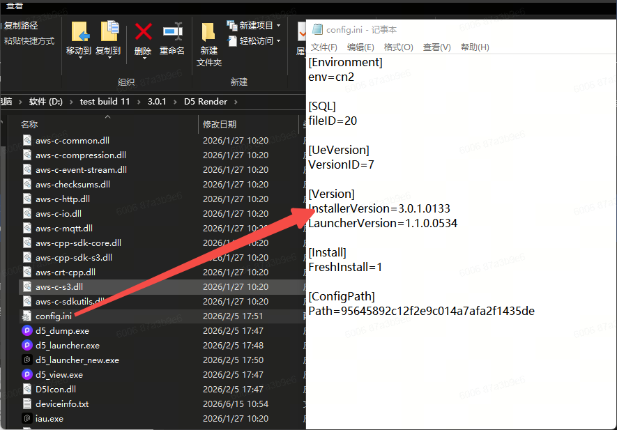

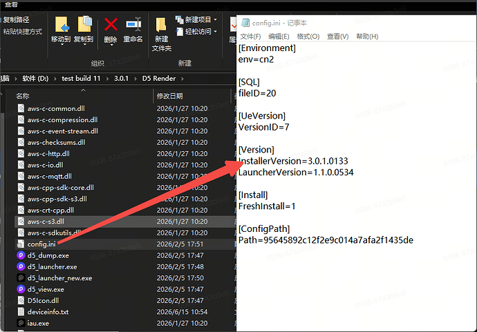

I checked and confirmed that the version is 3.0.1 or later. Why is it still not working?
