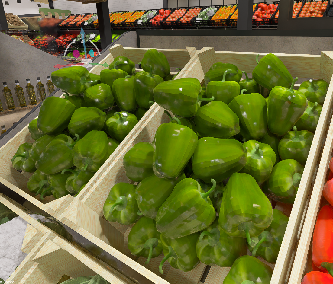

Hi,
when I use the LiveSync plugin in Rhino, objects in D5 are very low resolution and you can see the polygon edges.

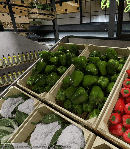

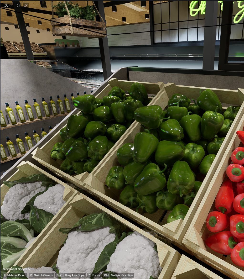

When the same scene is opened with the (old) sync plugin or via import in D5, the objects are in correct polygon resolution.
Can I control the number of polygons in the LiveSync plugin?
Livesync Plugin:
Sync Plugin:

Hi @t.klemens
Thanks for confirming. Basically, these low polygons are only visible to these vegetable models, right?
Additionally, would it be possible to collect your Rhino File so we can test it on our end? If there are privacy issues, then even a portion of the file where the low-polygon models are visible would suffice.
  • Please send it to support@d5techs.com and have it titled ‘Clov-Rhino D5 Livesync Low Polygon’
Please let me know if you have already sent it.
Hi Clov,
it’s the first time it’s happened, but I haven’t been working with D5 for very long. I will send you the Rhino file by e-mail.
Hi @t.klemens
Please check your DMs~
As for this issue, the fix will be integrated in subsequent release.
