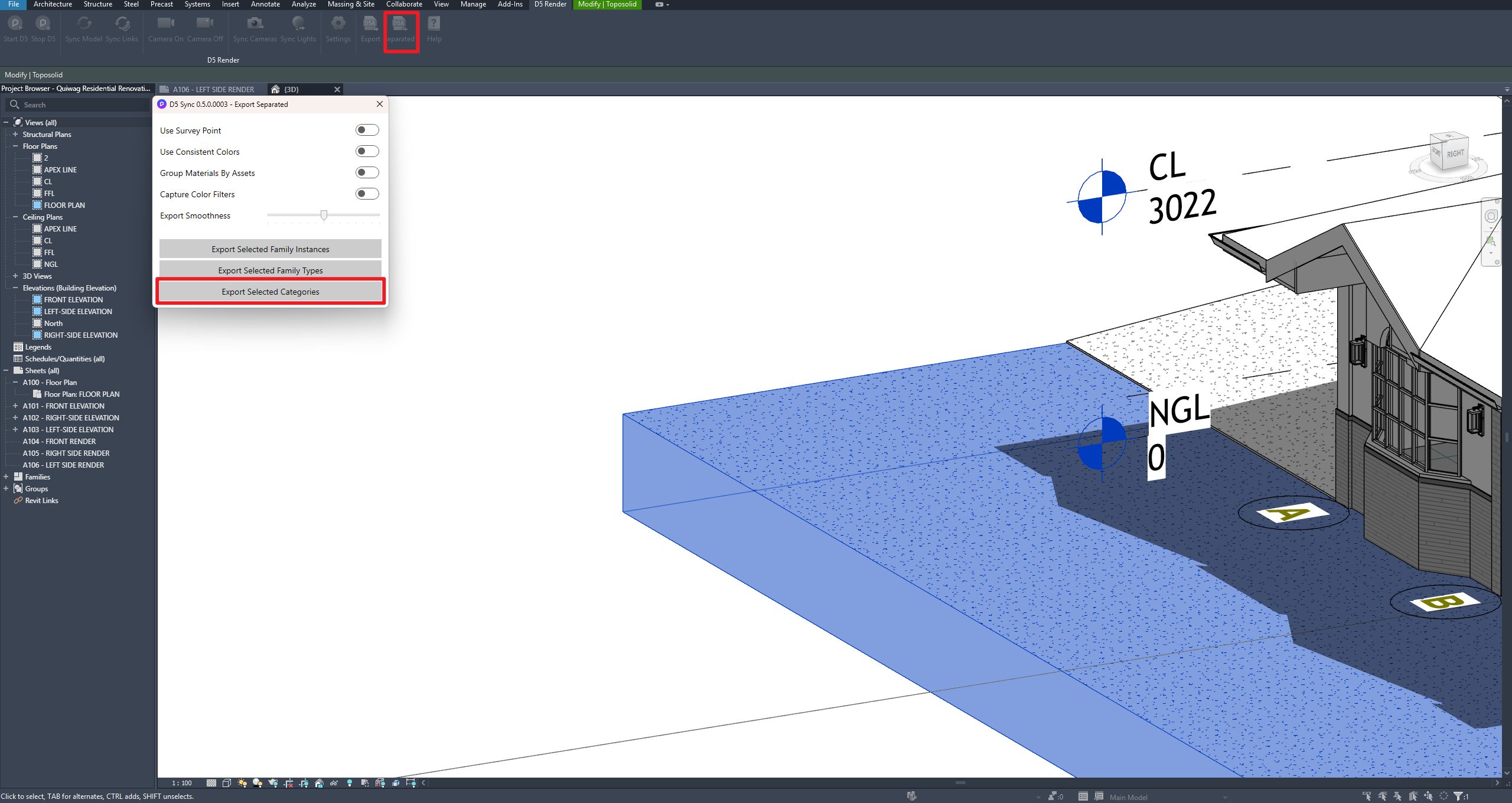

Hi @bcross
Please try this :
  1. Select the model in Revit
  2. Select d5a, then you can choose among the 3 options.
Thank you!
