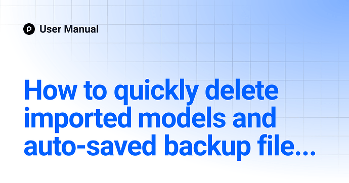

hi, this might help for time being.
Thanks,
It reduced the file size by close half to 2.1 gb. A lot though but better than previously.
