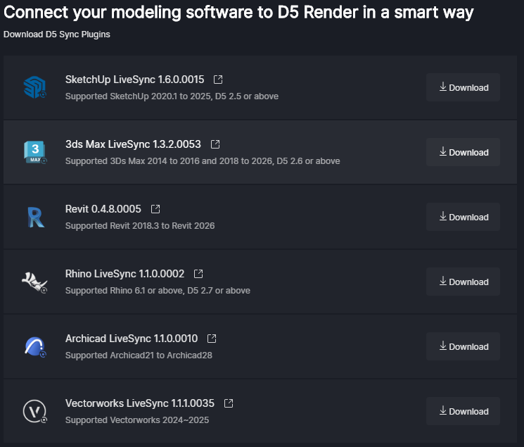

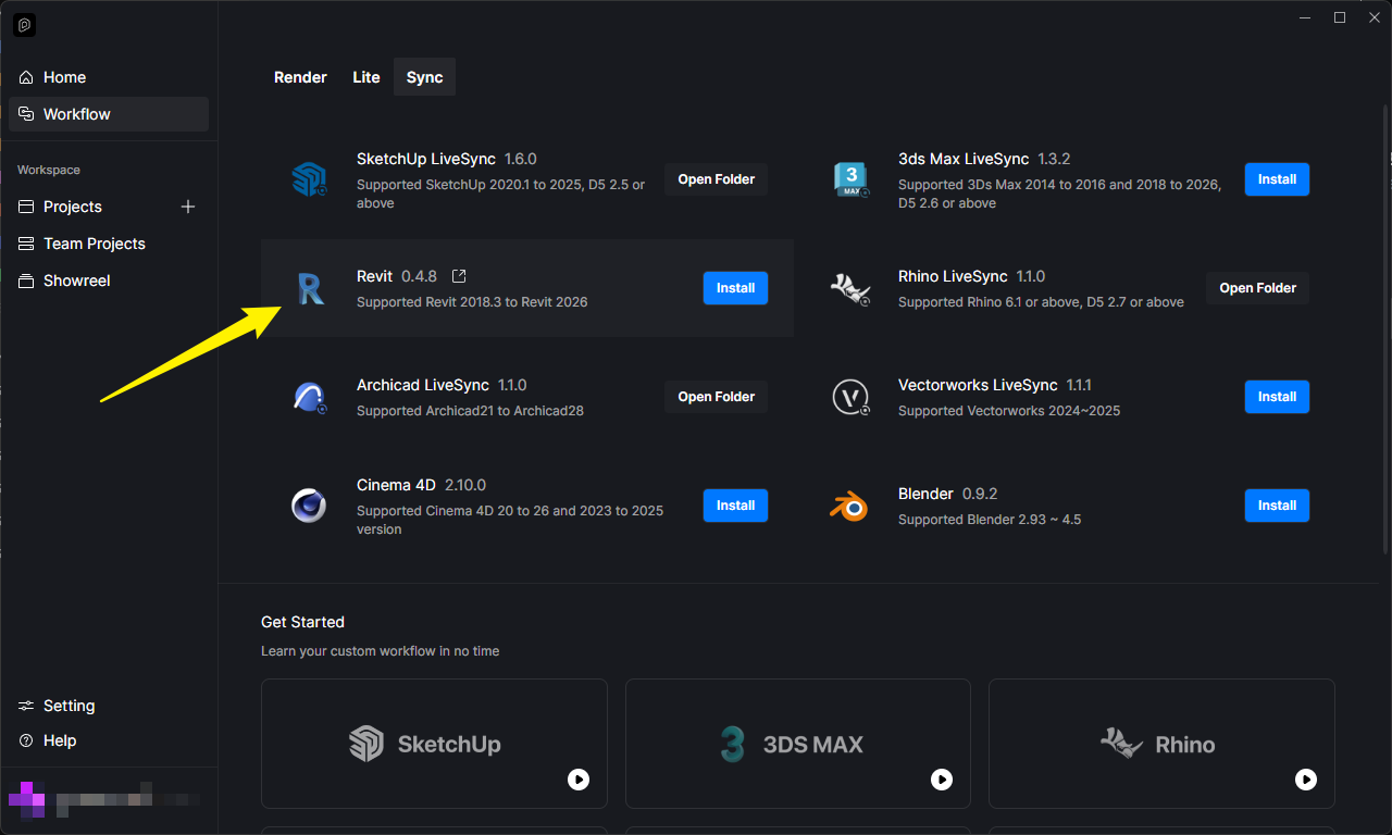

Hi @y-kib
What’s your plug-in version? Please try to download the latest one.
Hi Clov,
Thank you for your speedy reply!
I believe I am already using the latest sync version. and even if i do prompt up the workflow windows, I think I was led to download the older version? from the Installer i shown earlier (4.8.0006 > 4.8.0005)
Hi @y-kib
The layout seems different. Are you using D5 2.10? Or 2.11? I think the latest plug-in is compatible with 2.11. And currently, 2.11.1 is the latest one.
Additionally, I was able to test the section box again, and the materials didn’t reset on my end. Please send us a video recording so I can check the exact process.
