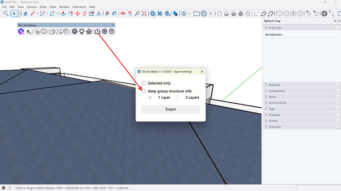

Hi @jacob.p you can preserve the group structure through .d5a export. Please ensure you are using the latest version of the sync plugin.

The .D5A workaround is useful because it preserves the SketchUp Group/Component hierarchy, but it does not maintain a live connection with SketchUp.
