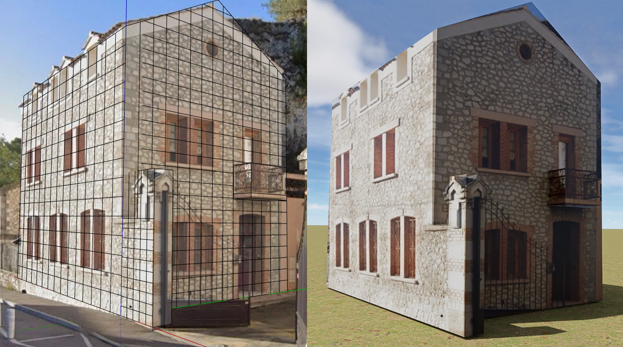

In truth, either I had never tested the solution I mentioned, or D5 Render has regressed.
Today, if you synchronize a SketchUp “photo-matching” scene after “projecting” the textures onto the geometry, D5 distorts everything—a disaster. Try it out.

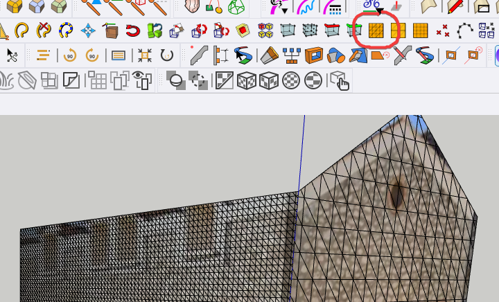

If you need to use Sketchup Photo matching, while waiting for a version that fixes this issue, you can subdivide the faces in SketchUp after projecting the textures. It works.
D5 viewport after synchronsing sketchup photomatch scene: it’s a mess

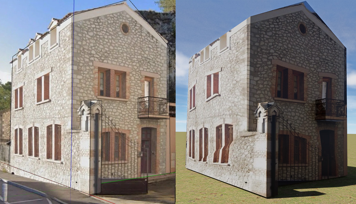

After dividing the faces in SketchUp, it’s fixed:
I recommand using this tool from JHS Power Bar, the faces must not be grouped, to easy divide faces
