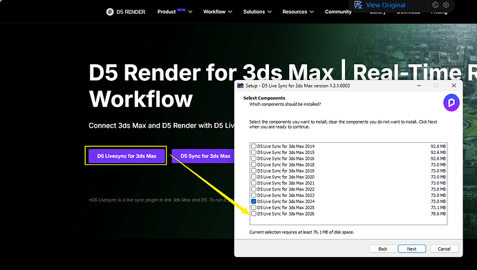

Hi Clov, thank you for your reply. I tried downloading the livesync straight from the official D5 website but during its installation there is no option for 3DS MAX 2026, only up to version 2024.
Did you select Live-sync instead of Sync? I tried it on my end to double check but 3dsMax 2026 option shows
