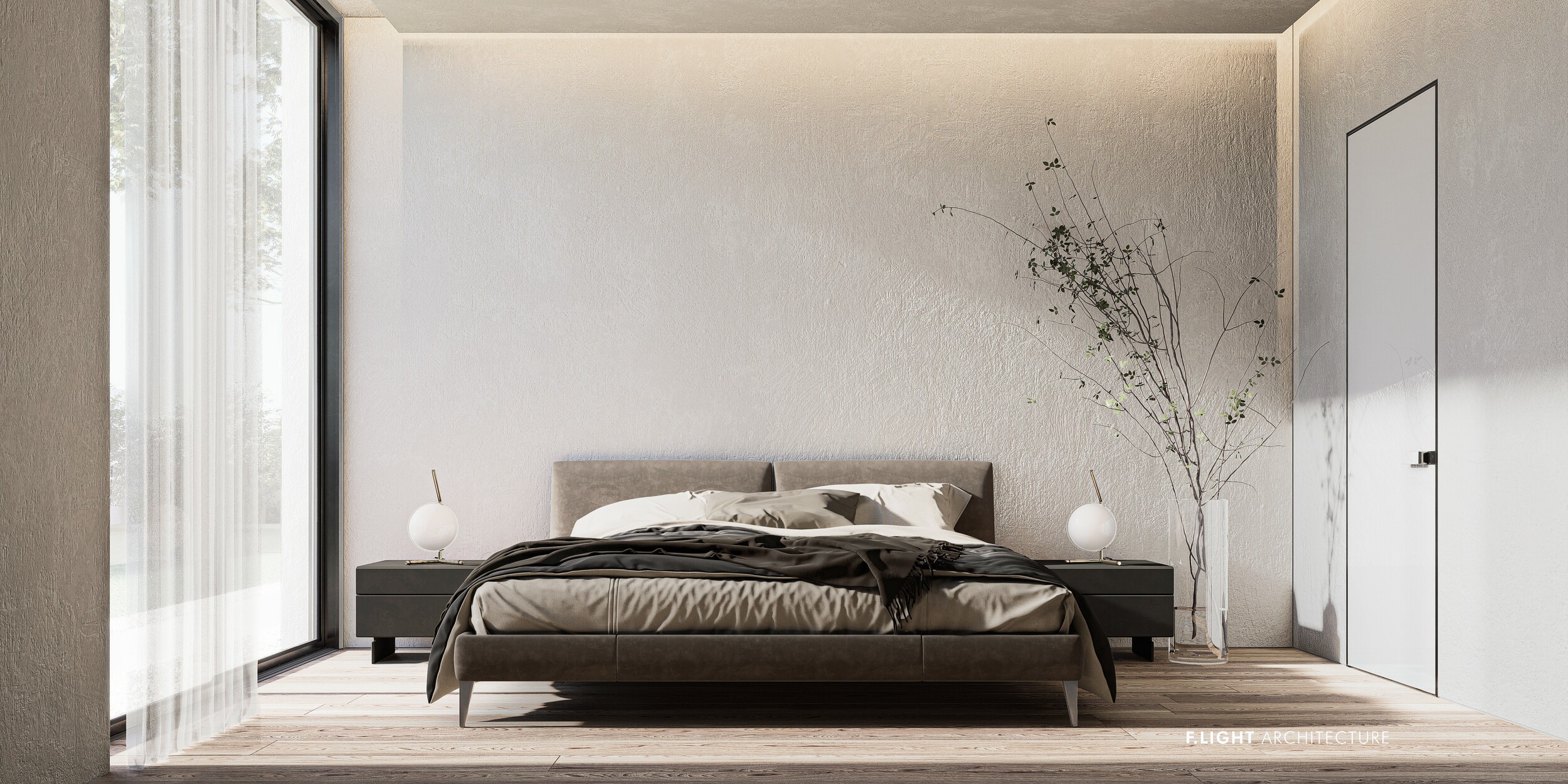

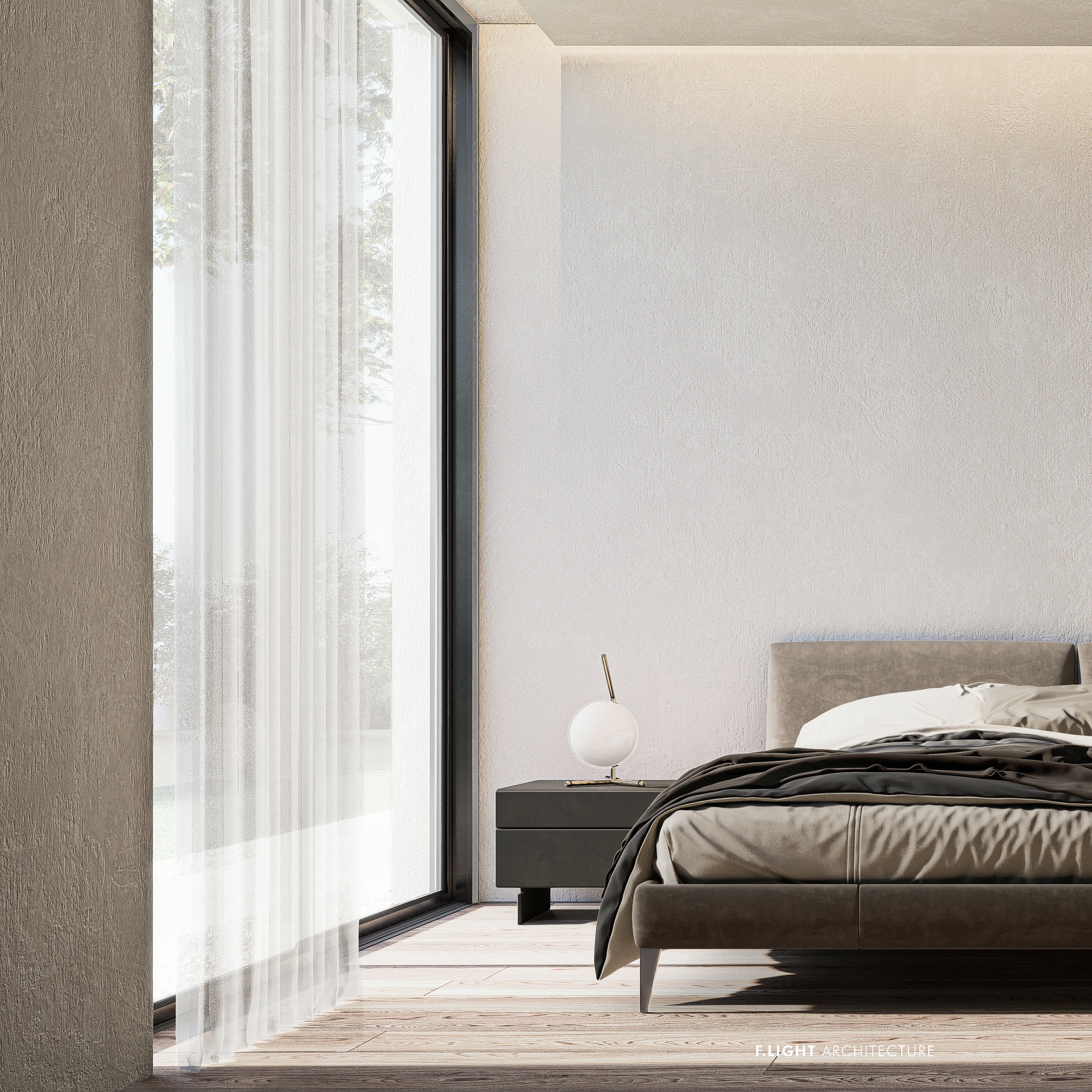

Very nice render. The curtains are perfect.
Can you please tell us how you did it, setting, etc.
My curtains are always “shiny” and look so fake. I miss the authenticity, the white transparency like yours
Thanks for sharing
Thanks dadi
Indeed it is hard to do decent curtains with current d5 gauze material. There are often some artifacts. Personally if my curtains are not good enough I use PS.
If I find some free time I will share settings or even a tutorial. In meantime, please follow these tips (I use sketchup, but I think it is worth to have this workflow in every 3D program):
• make sure that geometry is clean with correct front faces
• soften edges should be at correct level (check if there are any artifacts like grey faces)
• in d5 assign line gauze material with triplanar mapping with 1 size
• set opacity to 0.8
Check the results and if its not ok, play with opacity and mapping size. You can also use cloth or foliage material.
Good luck!
Nice and clean renderings. Good job!
Thanks Flamingo
I had many troubles with the curtain material as well, I will follow your tips and post here if I manage to do a nice render
thanks
Hi there, we optimized the 6 curtains from D5 assets library, you could update them and try the new assets. I think the effect should be better than before.
Hi Oliver,
Should I download from the website again? My current version is 2.0.1.0313. There is no automatic update request so far for me
Hello, no need to update the program. If you use those materials in D5 assets library, it will let you update the assets automatically.
