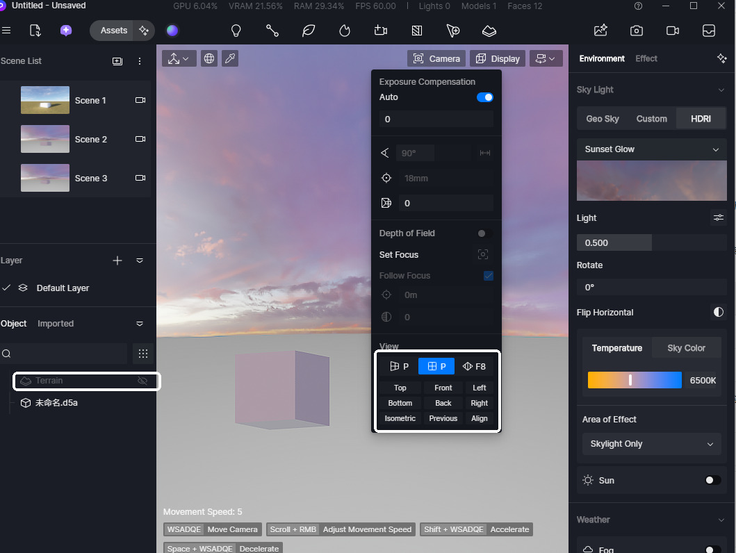

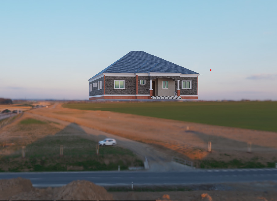

Why my model keep floating and how can I please fixe it?
hi, means that the model in the modeling software has a thick ground plane?
- Confirm the View in the current scene
- Confirm whether the model is missing a part of the model after importing render
No part is missing I believe , what do you mean it has a thick ground plane?
And how can I fixe this issue pleased?
There’s no established ground plane. Try to activate the terrain and see if it is floating.
- You can also select the model then modify the Y value close to 0
I activate the terrain it match with the model but you can see the space in between the HDRi ground and the activated terrain when the Y axis is 0000. I struggling with this for couple of days now as D5 learner, still can’t fixed it?
