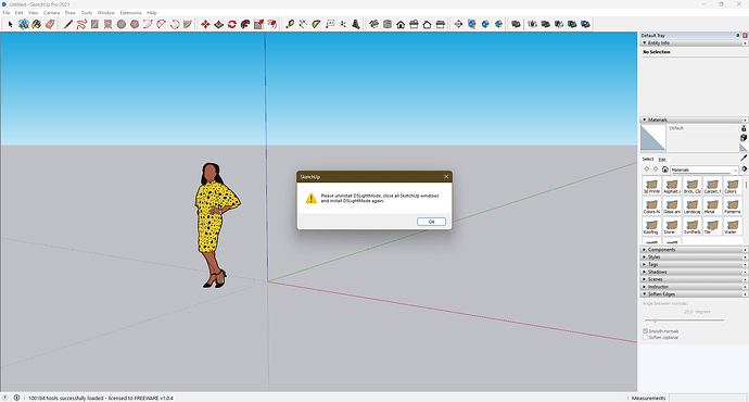

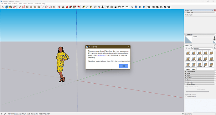

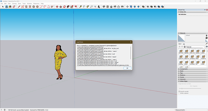

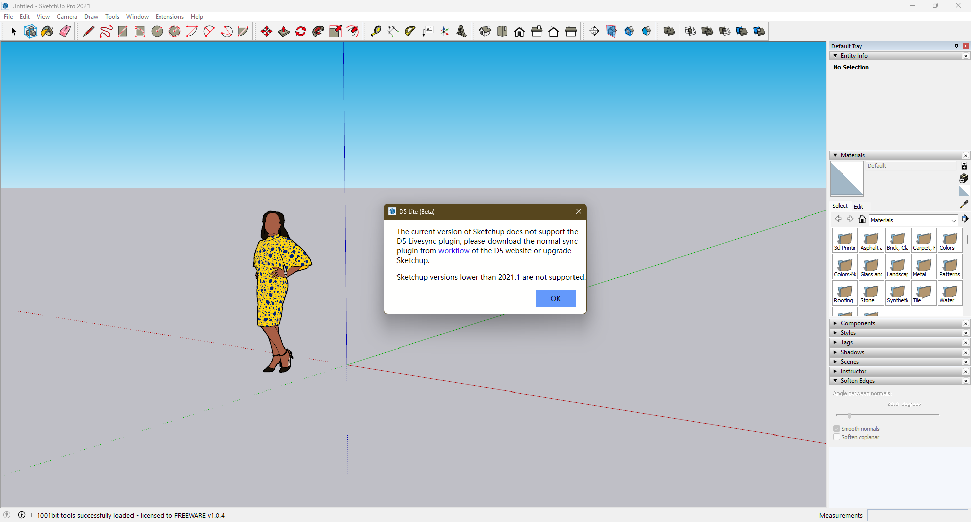

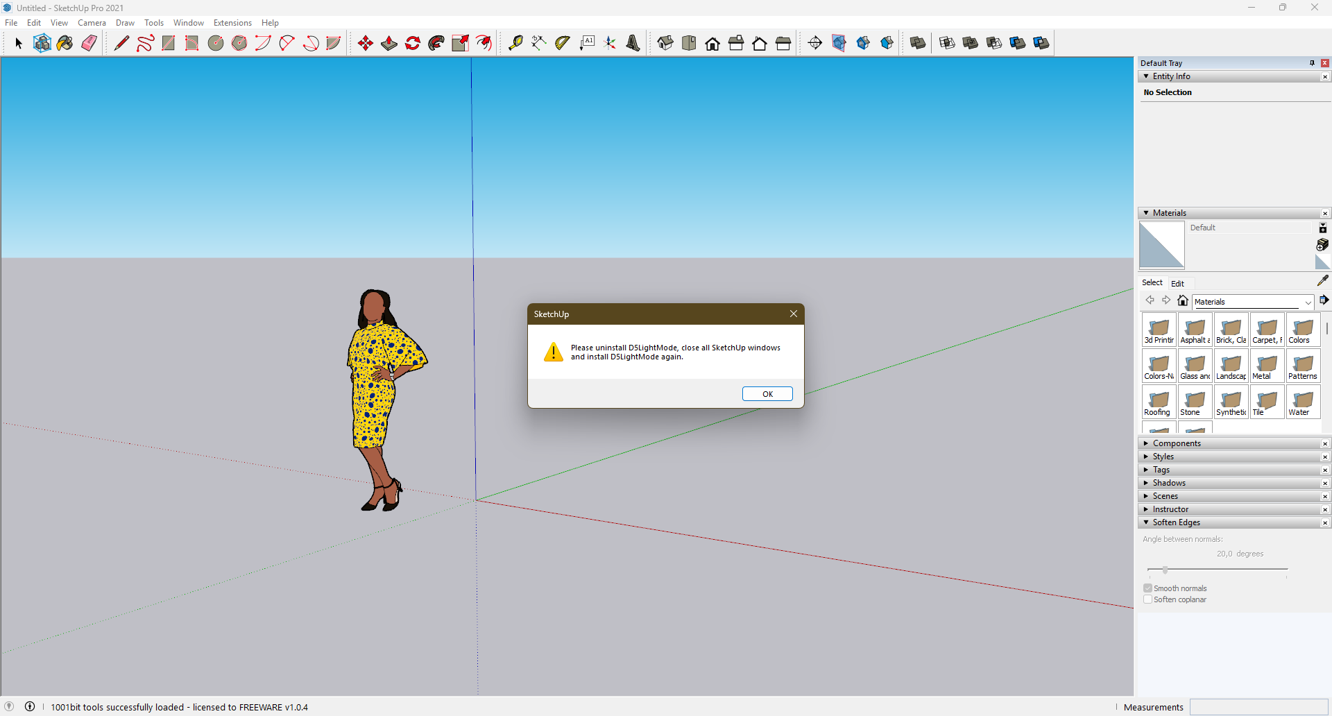

I might be wrong somewhere with this, but im struggling to get the D5 Livesync to work with SketchUp 2021. I installed the D5 update yesterday, but now I am unable to access Livesync. It might be a typo on the website, but as far as I am aware, everywhere says that this Livesync should still be compatible withthe 2020 version of SketchUp.
Ive also attached the images of all the pop-ups I have when I try to open sketchup and I have already tried uninstalling and reinstalling the Livesync.

No i have Windows 11, version 25H2. I managed to get the Livesync working again by uninstalling all D5 Software restarted my machine, and only reinstalled this morning when i got into work.
