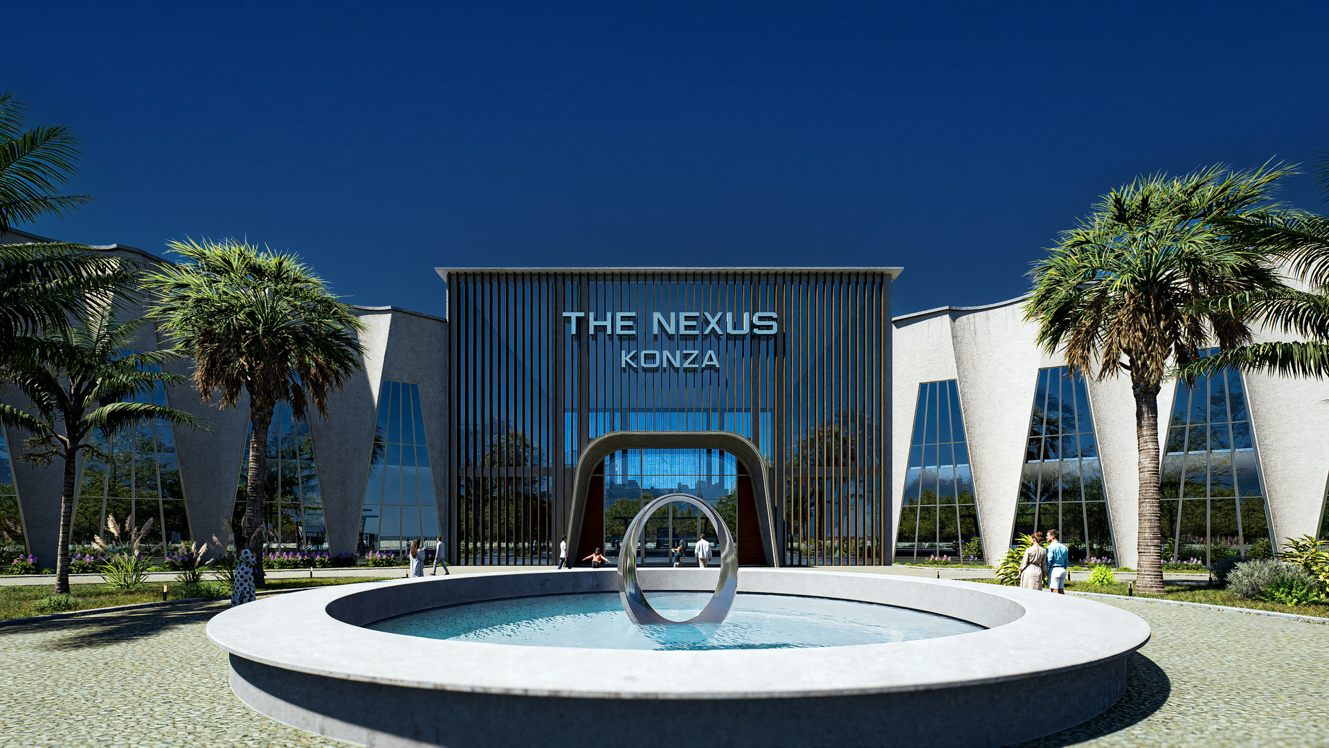

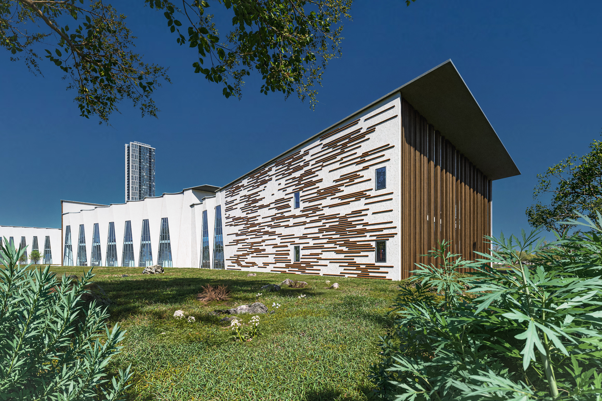

Konza Exhibition Hall
An Exhibition Hall in konza city
**Artist:**Me
I’m using RTX 3060 12Gb
I used ArchiCAD , Sketchup, D5 render and photoshop
This is a personal project
Rendered by me using path tracer (alpha), D5 2.10.
I have being rendering using D5 render . i have watched many tutorials from d5 render you tube page , Andy , upstairs etc. Their renders look realistic even before they start render but mine looks cartoonish and unrealistic . What can i do to improve that i need it to be realistic .
thank you
It allready has a good start… For what I can see the biggest problem comes from your lightning the sky is way too dark and the sun light really hard. Did you use an HDRI or did
just the geo sky…?
I suggest that you start with D5 curated preset and tweak them after to your liking.
If you wish you can send me your file and I will have a closer look at it.
I did use an HDRI from ambient cg.
Thank you. Where can i send it to you at. Here?
