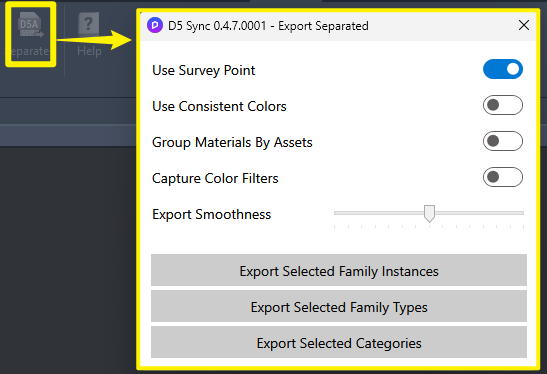

I have a problem I can’t seem to solve. When using Revit and D5 livesync I need to have individual instances of my Revit families, so I can later animate them. D5 groups them by category no matter what I try.

Hi @alejleal44
The sync option does have this option, and can only be done with the d5a export separated option?
Thank you very much. I wast just focused on the live sync menu.
