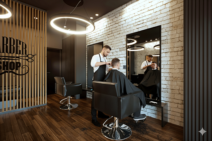

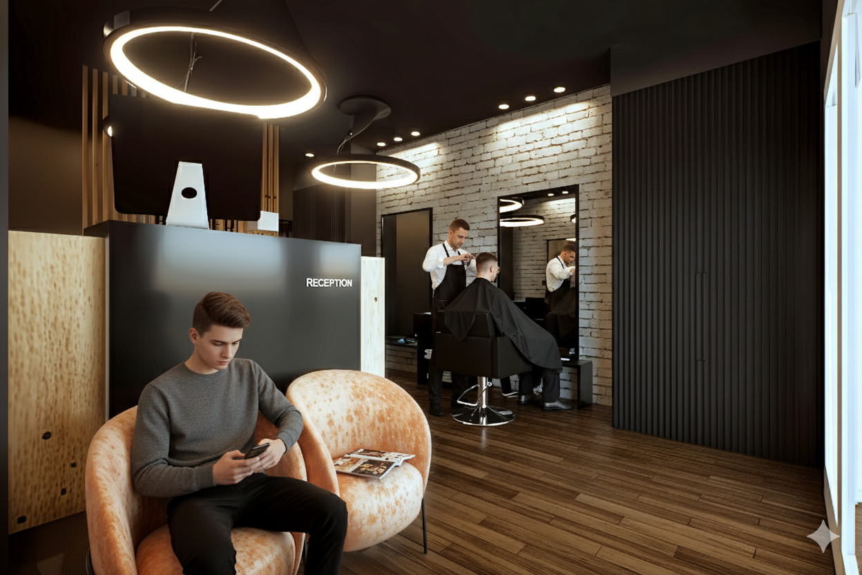

Hello everyone, I’ll put you some images of a previous job, a Barber shop, modified with Google Gemini App, very easy to apply if you were to insert characters, change background or insert objects, it’s fun, go to You Tube search Google Gemini to see how it works.
About and Free
This is modified with Google Gemini
D5
D5

secondo me un problema di D5, è la modalità pensata per posizionare una camera. Anche col plugin attivato. Le camere, risultano sempre troppo stretchate e si perde il realismo della scena. Idem per quello che concerne il bilanciamento di luci ed ombre. è complicato trovare un bilanciamento convincente. almeno per quello che è la mia umile esperienza a riguardo, sono piu propenso ad usare eevee su blender anche se sto provando a spingere d5 senza grossi risultati. CMQ bel salone.

hi, very nice design and lighting. using AI is regular practice now days. and u have used smartly congrats. one more thing i noticed that reception table and monitor is not look in proportion. please correct me if im not right.
ceiling looks completely dead, can be use little reflection.
keep going.
thanks

Hey there, What type of prompt did you use on those images?
Good morning, sorry if I answer you after 6 hours but here in Italy it is now 6:35 in the morning, I have now seen your message.
I used Google Gemini, just connect to Goo, gle and ask Gemini for Image edits, just enter the image and a text indicating what you want.
It"s all free, but the format you get is small, you have to enlarge it in Pixsel with an image program.
