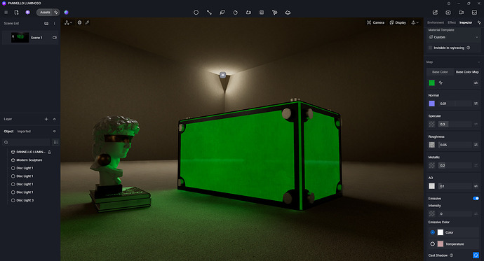

Hi, I read your problem, and I tell you this, in the video of the D5 2.8 shows a type of translucent glass that is illuminated behind, now you place it:
You can download this file from the Express scenes, but being curious of nature I made some tests with the material you exposed but otherwise as you did, because in its simplicity it was enough to give more color to the material, in short, darker than that sharpness.
Then with the light shot above it was normal that it lightened, I tried with the material no transparent but normal, because it did not emit the light, so it made it emissive and I gave it color and mirror it also increasing the metal part.
Sorry for English I use the translator too

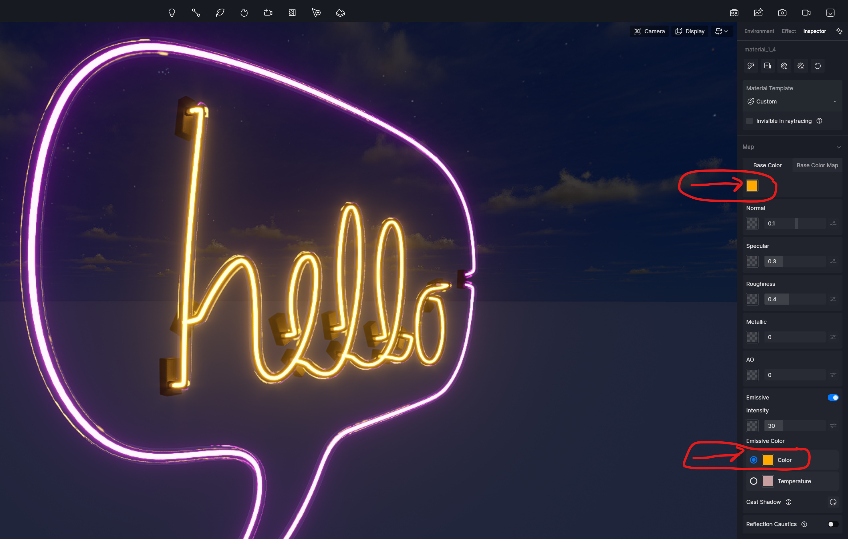

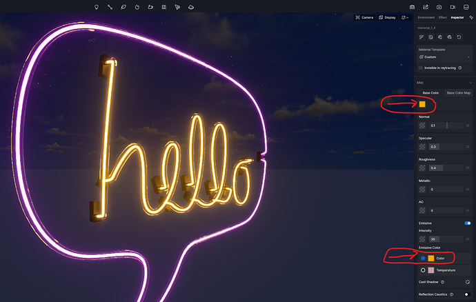

Hey! To keep the intensity you want to change both Base Colour and Emissive Colour. Hope it helps :smiling_face:
Thank you riccardofortelli.
I will try your setting.

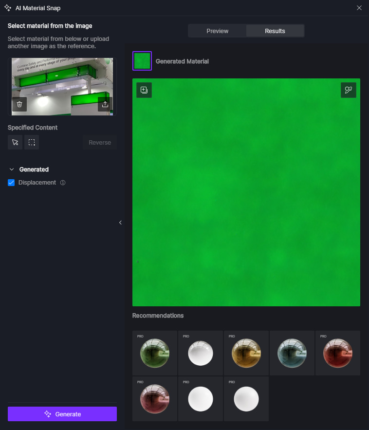

Hi, I also try to create that material with the new function, which is in the material panel at the top right. load the reference image you posted see what kind of material it provides you,
trial
:grinning: :grinning: :grinning: :grinning:
Here is the result
It also gives you other glass materials that are already in the D5 bookshop

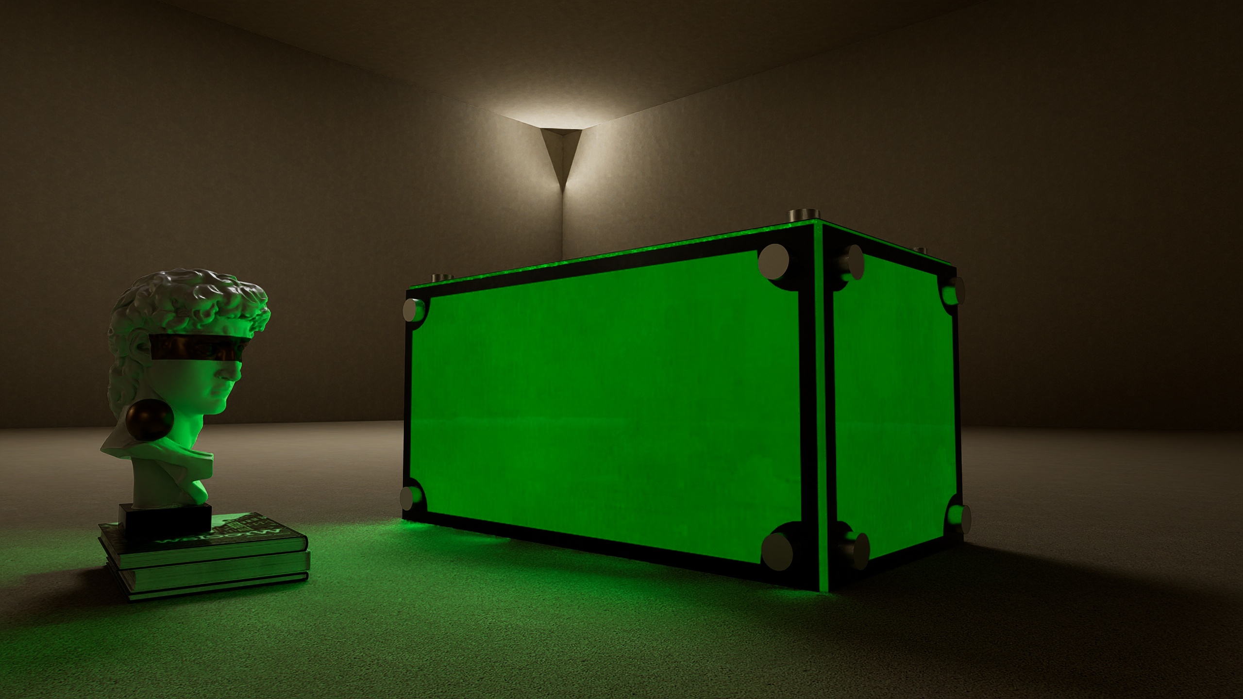

this is the result
Thank you Marina.
But I wonder if the big area is the same.
I think it is the same thing when I do it.
I will try more haha… Thank you
