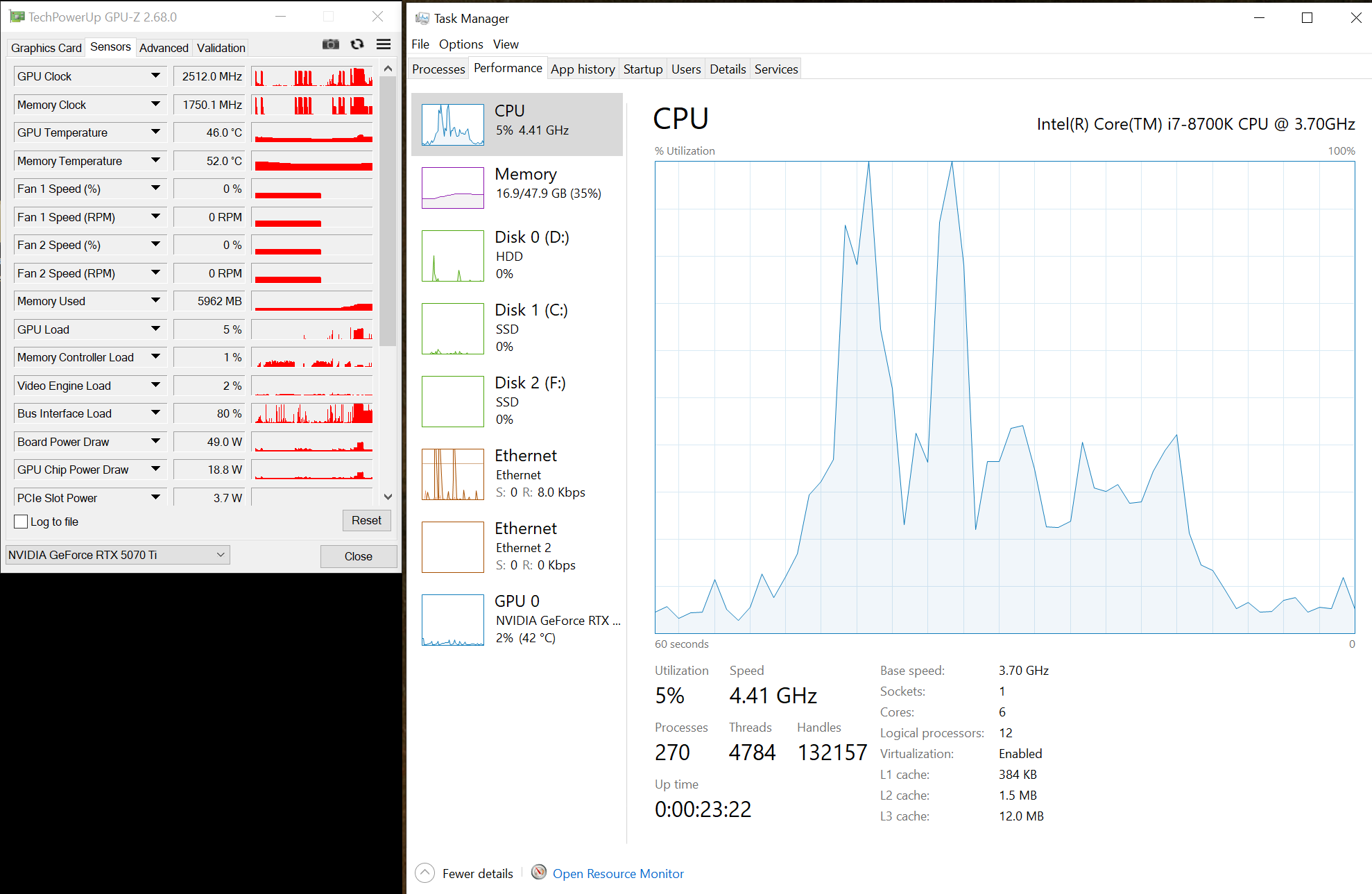

sorry to hear that you ran into the problem. Could you try opening the demo scene of D5 then check the result? Also, please run D5 benchmark tool then show us the result:
D5 Render
Besides, the Windows resources manager may be not accurate, you can try monitoring the VRAM with GPU-Z.
If the problem persists, and it happens to a specific file only, then we may need to check your file for further troubleshooting.

From the benchmark results and GPU-z, we think the GPU works as normal, but you may need to make sure the power supply is large enough.

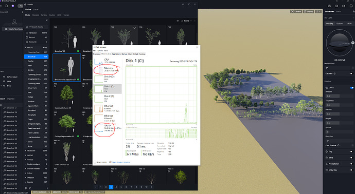

The orginal file indeed is quite heavy (13Go of assets), I try to make a file where I can preview all trees. When I start rendering, it fails at the end.
Just having the scene open, im at 90% memory usage…

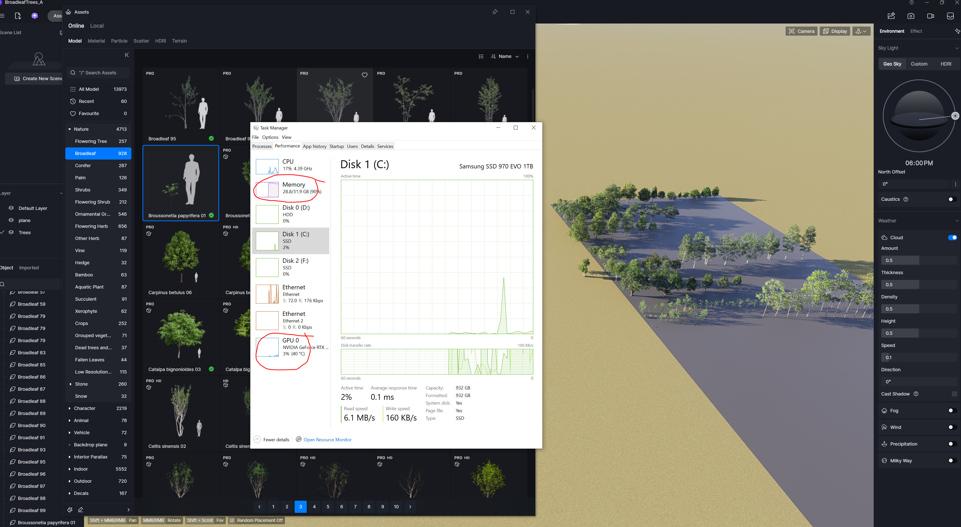

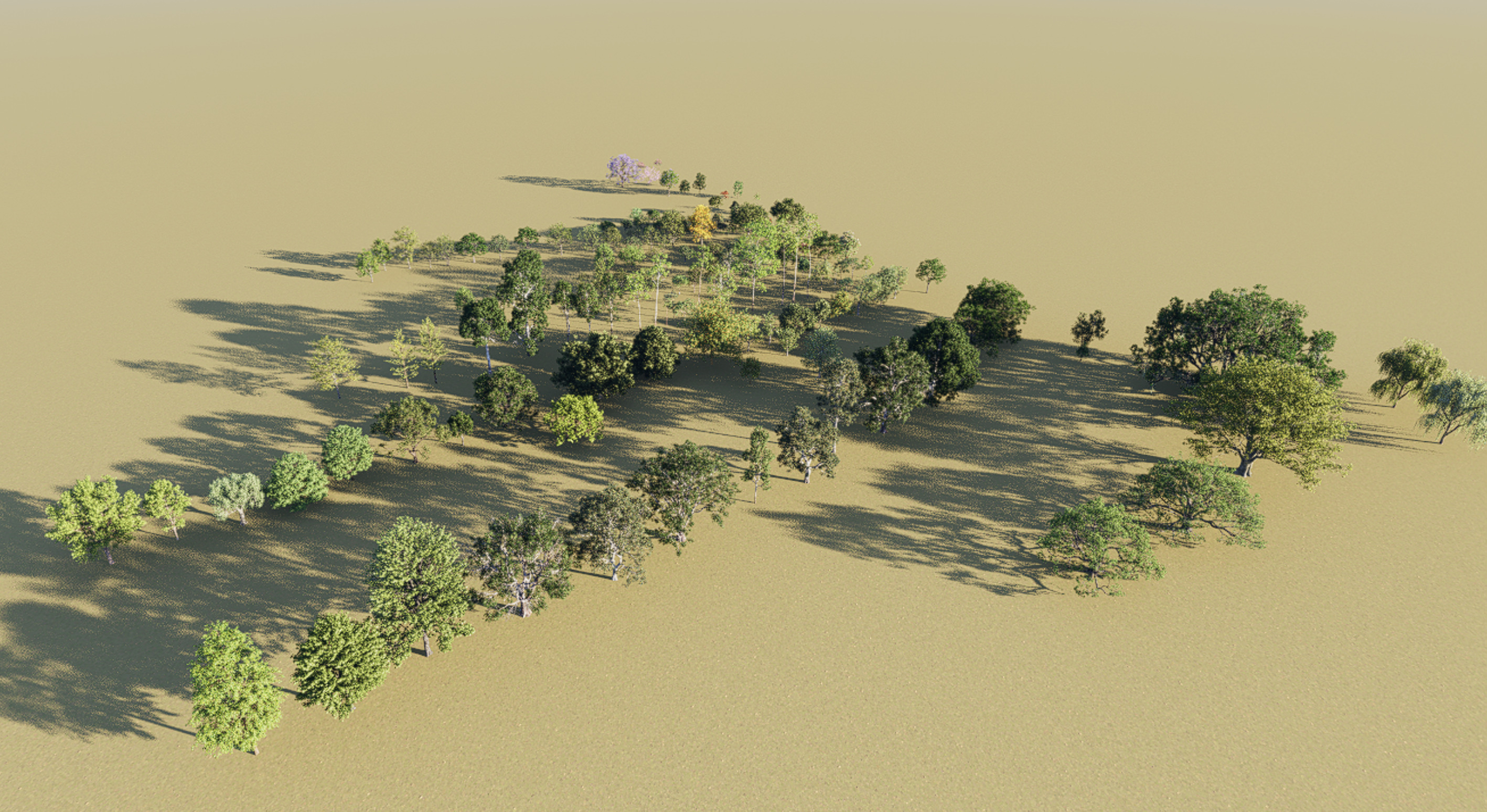

I tested with a more modest scene. I put only 70 low poly vegetation assets (all different).
4k rendering
here is my performances.
Still 50% of memory used … this is huge no ? for a basic scene

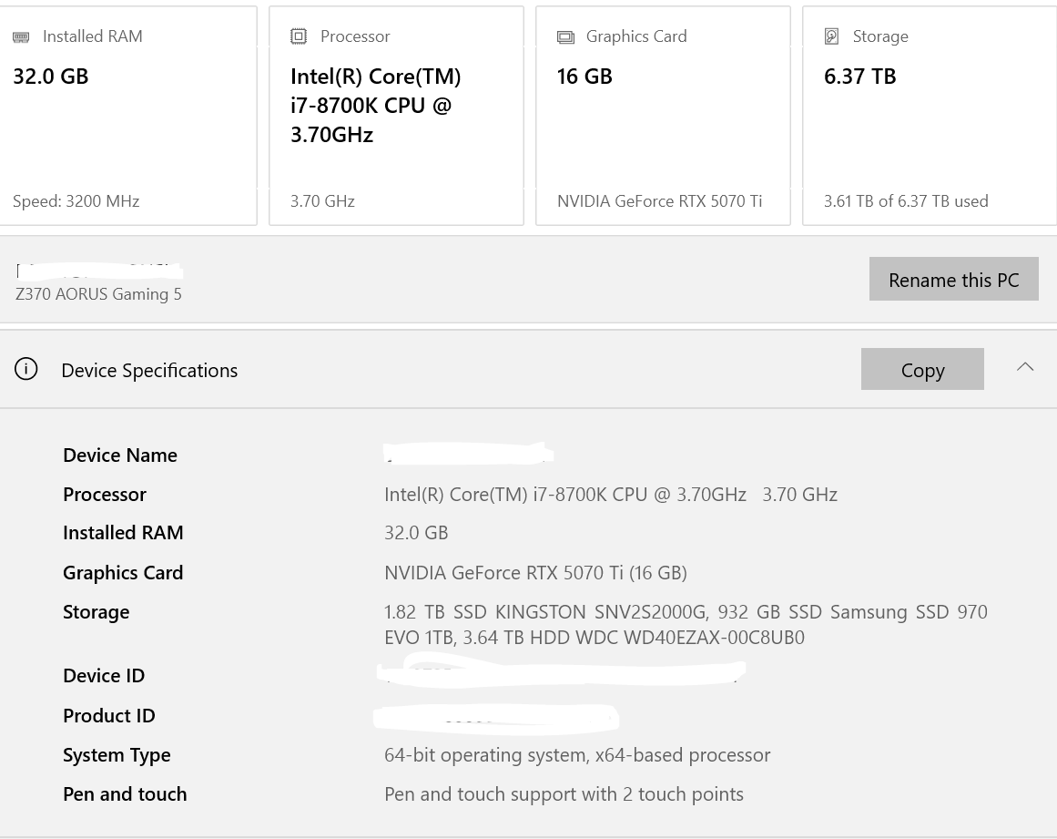

here are my pc specs
So if you can help me understand why the memory gets overloaded so quickly I will update my way to think in D5 modelisation.

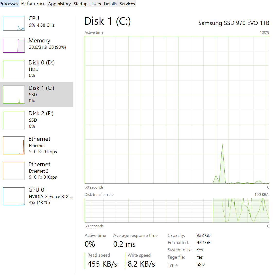

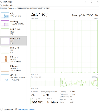

Just want to know, the GPU doesn’t seem that overloaded … (15% used here). But the memory is almost full. Is that the issue? We are talking about my PC memory right, not my graphic gard memory ?
And finally, is there anything I can do to lower that stress on Memory ? Empty cach or somthing ? Or just upgrade memory space and speed?

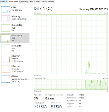

EDIT

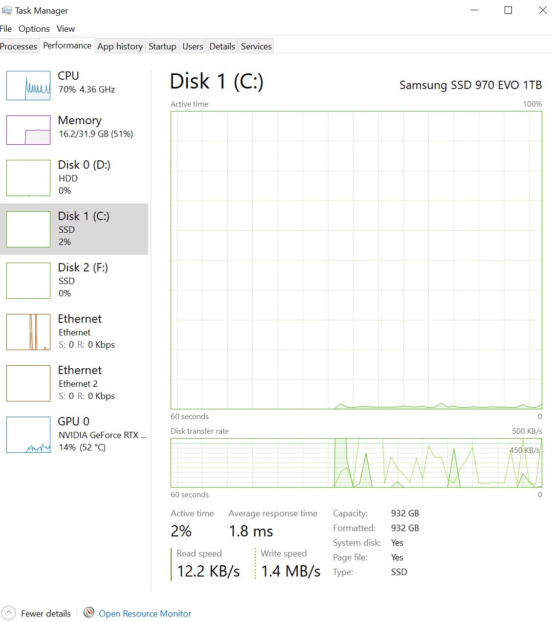

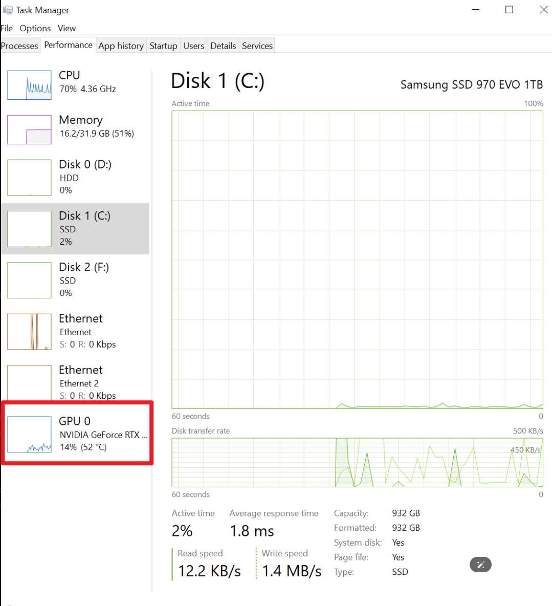

Another test. CPU almost 0 and memory full.
Thanks
CC
Hi @charles.collin.2
Aside from opening the file you have created with only tree assets, does opening a completely empty file also spike your CPU Percentage to 90%?
  • What is the CPU usage when D5 is closed? Can you send us a screenshot?
  • Please generate a log file, you may send it to me privately here in forum.
Yes CPU spike when loading a blank D5 scene.
