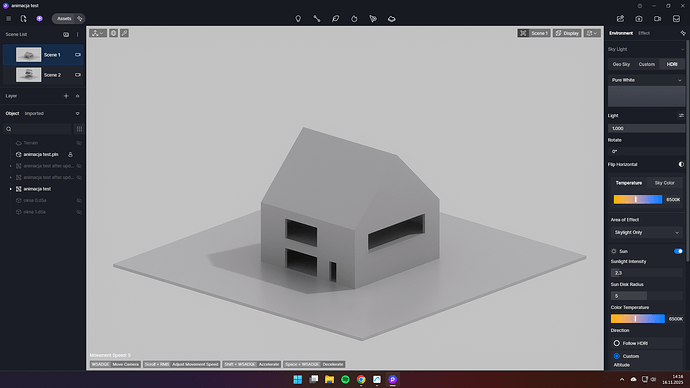

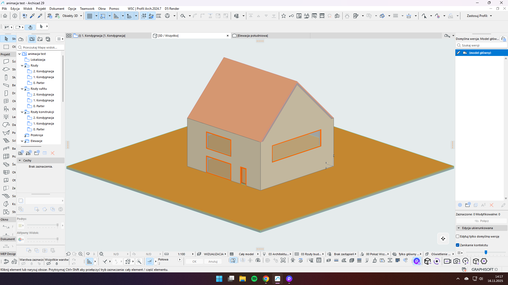

By saying that openings are ignored, I mean that there is a hole in the wall where a window should be, but without the actual window model.
You can see this in the provided images: in Archicad I placed windows and doors, but after importing to D5 there is only an opening in the wall, with no actual window objects.
