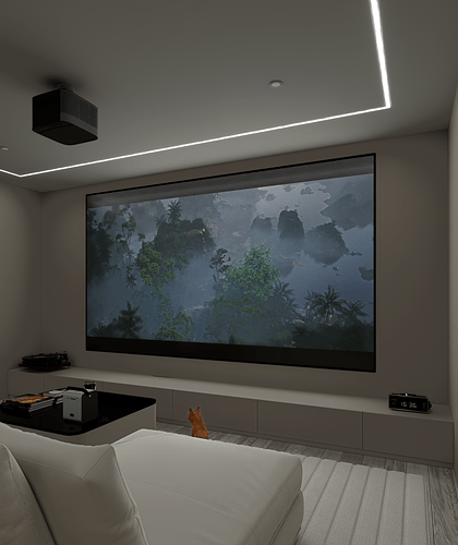

Entertainment room
Jumping into the world of D5 Render! This is my first render,
and I’m eager to learn more after using V-Ray and Enscape.
Looking forward to exploring its capabilities.
Artist: Myren DM
Graphics Card: RTX3060
Workflow: Skp + D5 2.8
IG: DMcreativestudio
Welcome to Forum, @DMCS .
Simple model but gives a good impression, I really like this scene. But if it was a little brighter, it would have a better effect.
Thank you.
correct more light from the screen itselfs would be realistic
Yes, that’s what i meant. The screen is brighter but the surrounding scene needs to be a bit darker, to give more impression to the screen. And the ceiling light line should be changed to a bit warmer tone. Try it, i think it will be different and better than the current render.
my i ask what is the best option to do projector screen to the wall. i try the basic model (plane) and apply with materials(multimedia+transparency 0.9). i have this problem with the edge of screen, is there a method i can use to ensure the edges are smooth.
Have you tried Projector lights?
projector light? No sir. not yet. do you have link on that?
it is a light in D5 but it needs pro to use
projector
wow! ok sir. ill try on it. so far im still using community version. Thank you. :man_bowing:t4:
but projector light doesn’t make the edges smoother, it just adds realism to the scene, i think your scene is fine, just needs brighter screen and darker surroundings to create depth
Thank you. ill try other method.
ill try to fix the edges of screen soon.
Plane Object + Material(multimedia 1% transparency) + Rec light
it better
turn down the screen light a bit, it’s too bright.
change the ceiling line light to a warmer tone
compare this new scene with the old scene, is it better?
