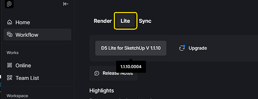

How does the Lite download entrance display in your Launcher?

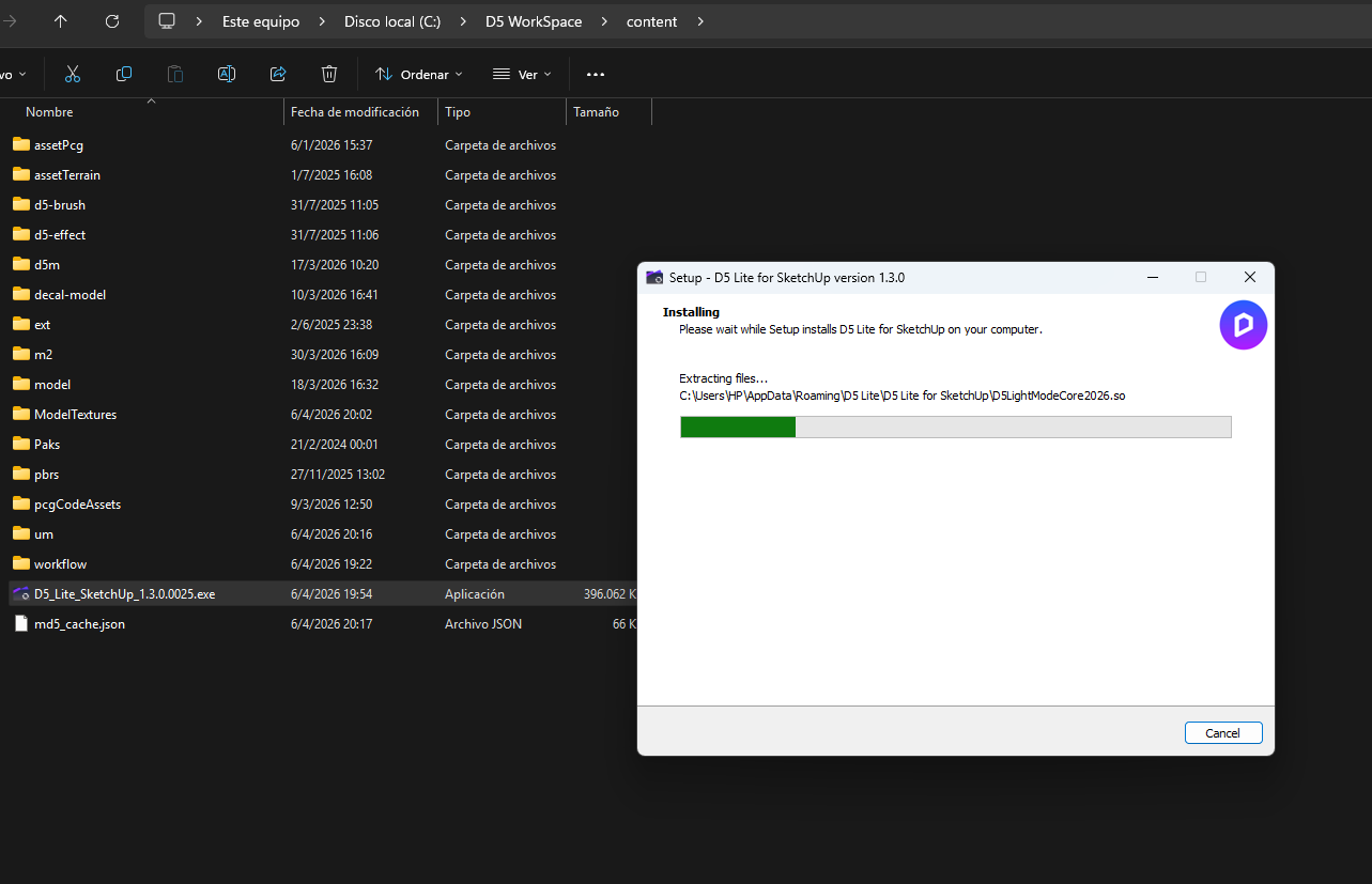

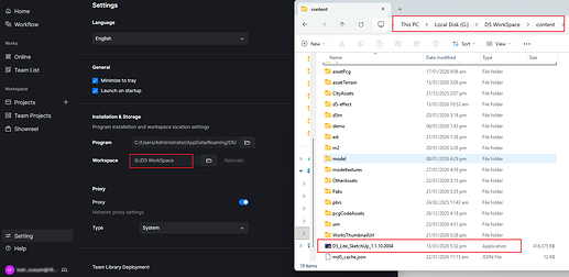

If you have downloaded it before, you can locate the WorkSpace/content path to find the Lite installer for reinstallation.
Hello, i had the same problem. To uninstall D5 Lite, go to your PC settings, then go to uninstall program, search D5 Lite and uninstall frome there.
If after that you can´t install it yet, look if you have the .exe at this location
