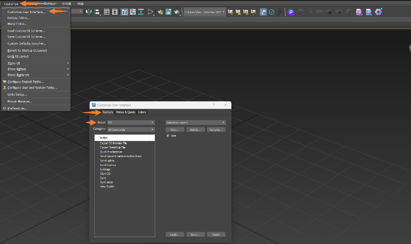

If you can find D5 in this menu, but the plugin toolbar is not shown, try the following steps.
Select the “Floating Toolbars” to check if the D5 toolbar shows.

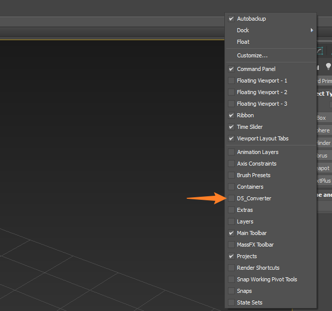

Can you right-click your toolbar and check whether D5 Converter is ticked?
  • Can you show us some screenshots too? Preferably when right-clicking your toolbar and if D5 comes up in Customize UI
