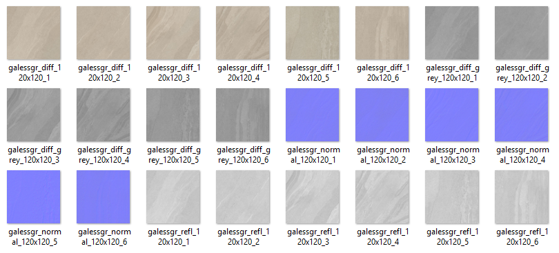

Can you provide us with some images of the material (tiles and bricks) that you want to apply to D5 Render?
  • Under normal circumstances, materials can be applied even if Livesync is enabled or if Resyncing is done.
The material is made up of 6 images in each channel: diffuse, normal and reflection.
Here I leave a link with the folder that contains the images.
https://www.dropbox.com/t/8HmiYU7zI28ngNon
