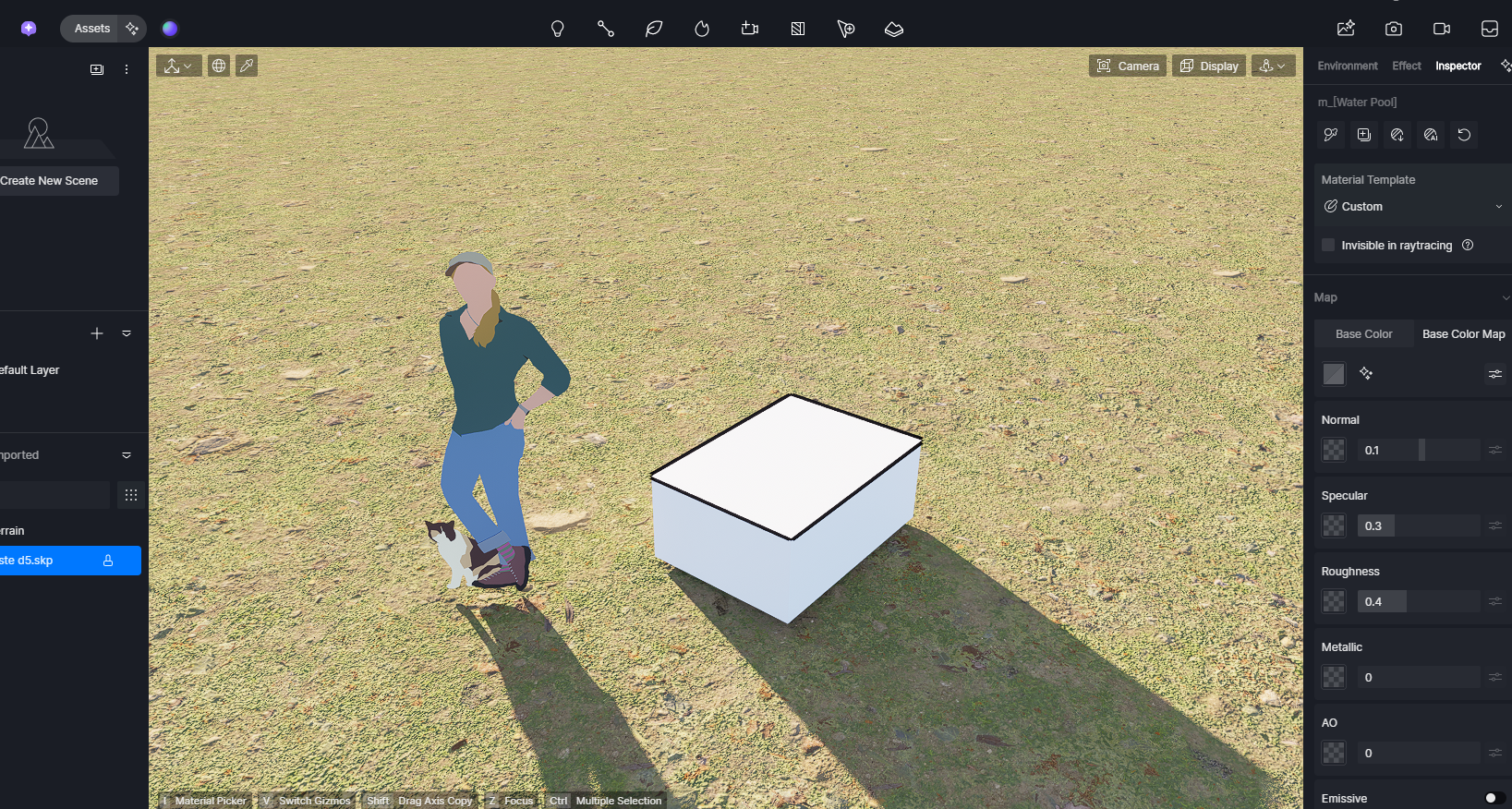

Hello,
I’m experiencing persistent issues with D5 Render (latest version) when syncing with SketchUp 2023. Here is a detailed description of the problems:
  1. Materials not importing correctly:
    When I open the SketchUp file in D5, all materials appear white — even though textures are correctly applied in SketchUp. None of the materials from SketchUp are transferred.
  2. Cannot apply D5 materials manually:
    Even within D5, I’m unable to apply any of the native D5 materials to the model. Nothing changes on the geometry — everything stays white.

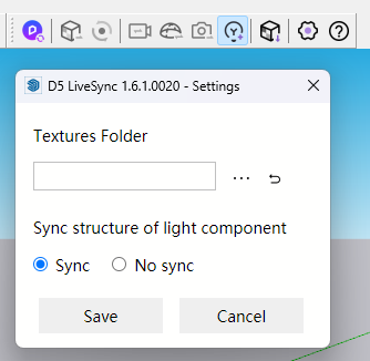

  3. LiveSync “Textures Folder” window keeps popping up:
    Every time I initiate LiveSync, a window appears asking for a “Textures Folder”. Even after selecting a folder or clicking “No Sync”, the issue persists.

Captura de tela 2025-11-17 083548
