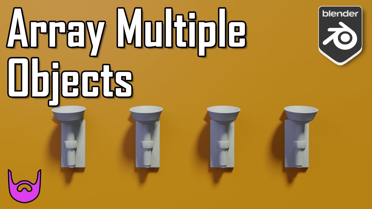

Also, in the scene I am creating in Blender, when possible, I want to use copies of the assets from my asset library so that the Polygon count does not increase unnecessarily. To accomplish this, in Blender, I use a technique called Array Instancing. See link below.
Hello, really thank you for your video. The objects created by instancing faces could not be sync to D5. I think this cause your problem. We will try to find solution for this.
