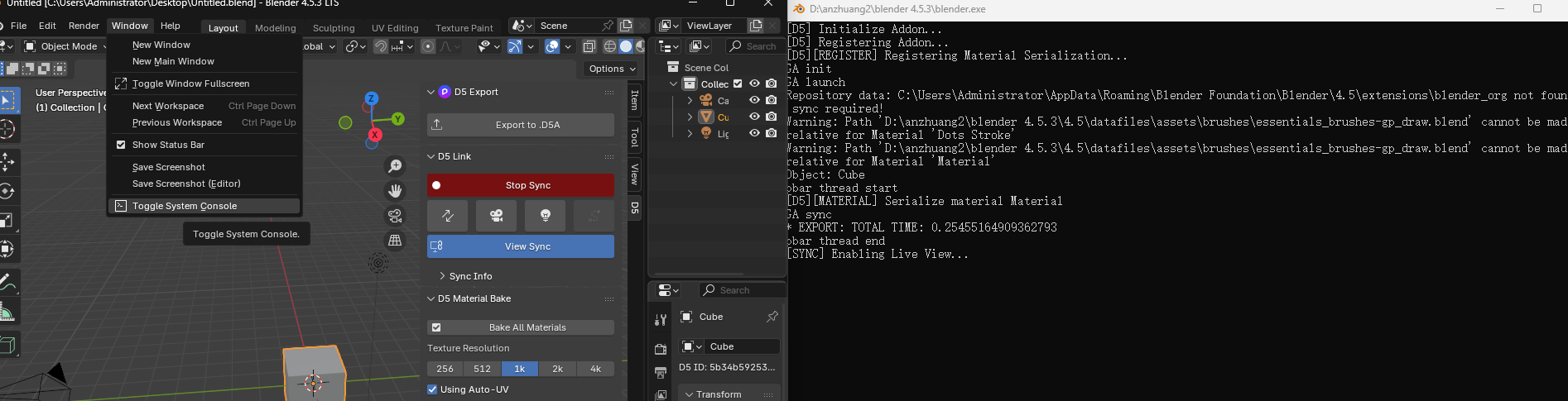

  • After minimizing D5 and triggering the replacement window, canceling it, and then triggering the replacement again, Does both D5 and Blender become unresponsive, causing the machine to freeze?
Is D5 minimized when you use the Sync Addon to synchronize the model?

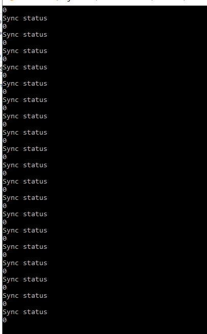

Computer is not frozing, only Blender, this is what console looks like when trying to sync without the d5 file already opened. And now if a open the file it takes like more than a minute for each sync to succesfully happen, withour errors on the console. For now it seems like its new files specific like this project, when I open previous ones and sync it works fine like always.
