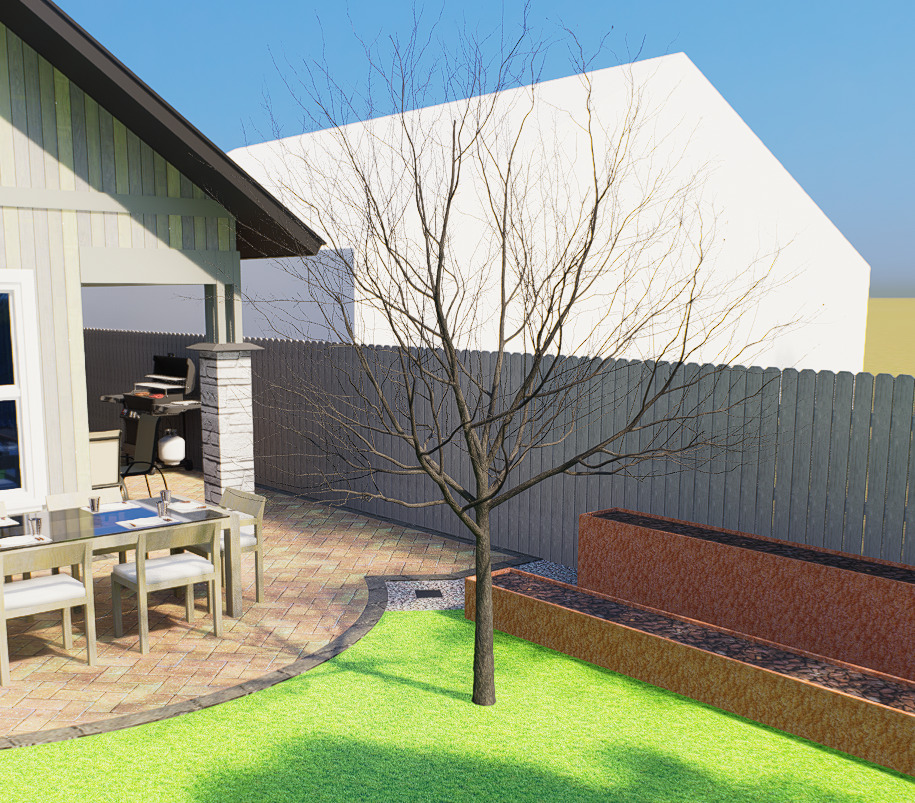

I found a pretty decent workaround to this
Take a tree model and select the leaves
Turn the texture mode to transparent
Put refraction at 0

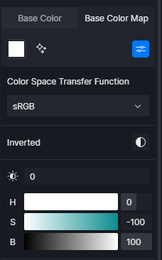

Replace the base color map with a pure white screenshot (I just took a screenshot of the google search bar)
And make these the settings for the base color map
And there ya go
Genius! I wish I’d thought of that instead of importing lower quality winter tree models from elsewhere.
