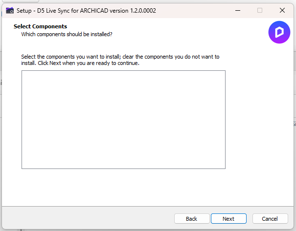

**Issue Description: Hi, I am using Archicad 27. I downloaded and ran the latest version of the Archicad Live Sync but during installation. However, during installation, the option to select Archicad 27 is not there in the menu. Are you able to assist urgently? Thank you.

  5. Could you provide a screenshot of the installer window where Archicad versions are listed?

  5. Screenshot attached

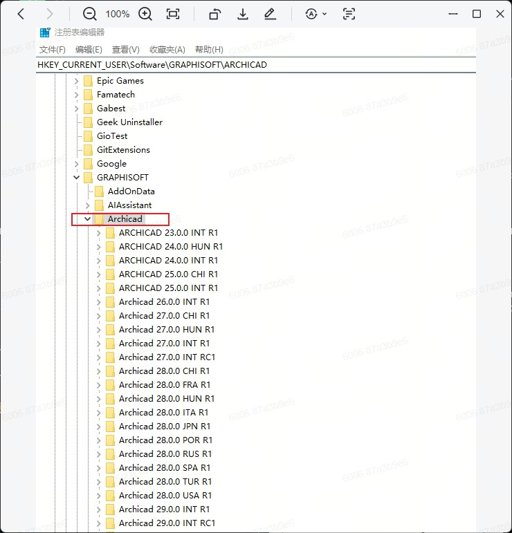

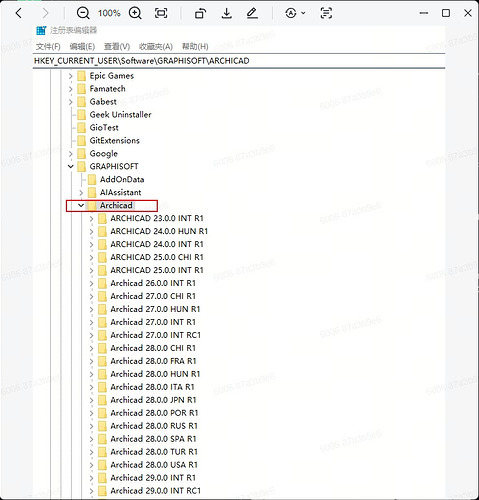

Can you please check the properties and confirm that you have full control over this folder (where the ArchiCAD Plug-in is located and installed)?
  • You may also check your Registry Editor and check this portion; please send us a screenshot.
