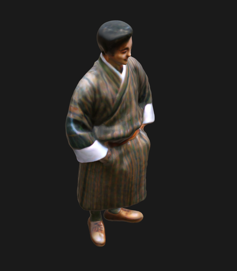

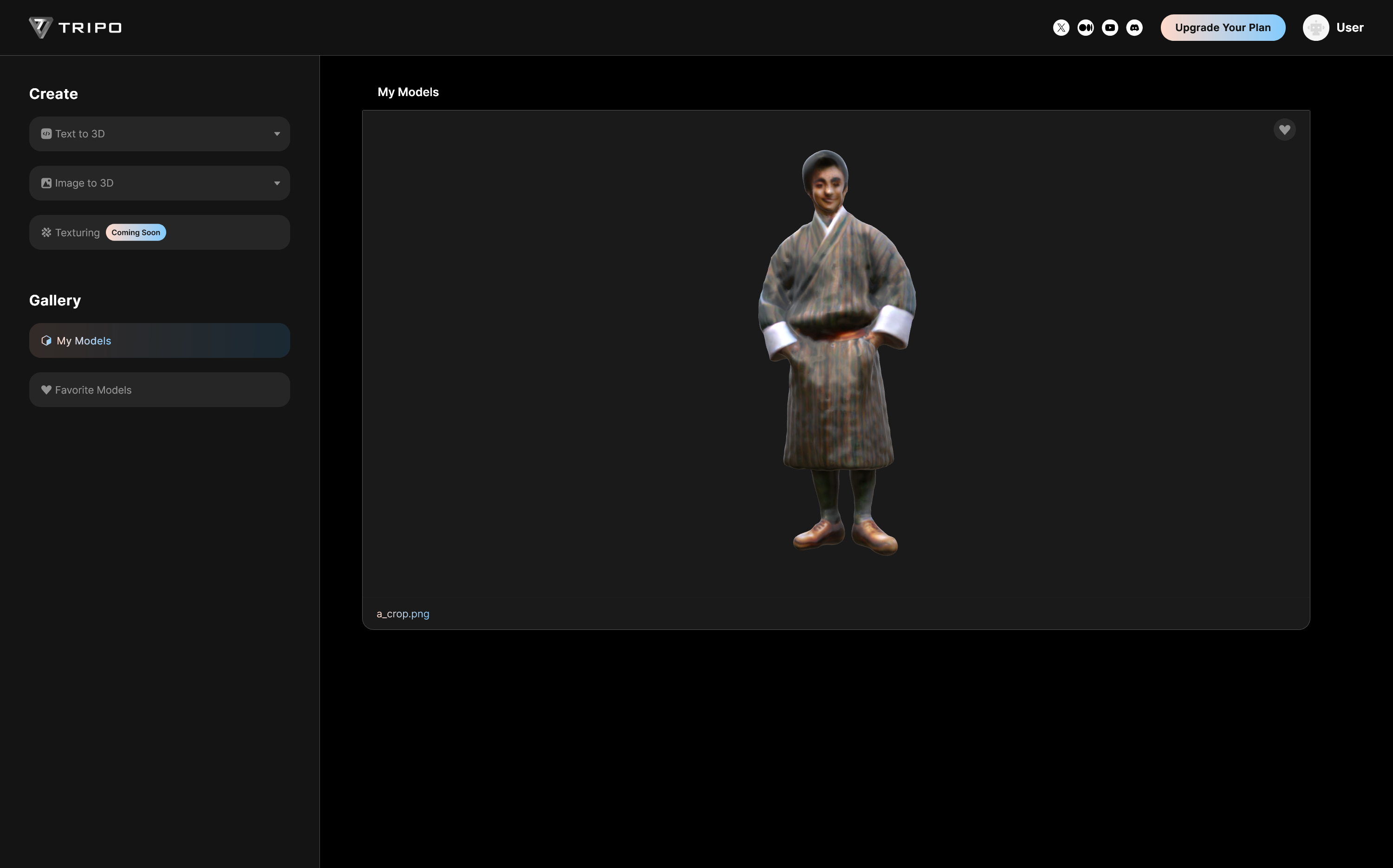

  5. Tripo AI: Created a 3D model from the image. Texture and mesh are very blurry, but it is quite well interpreted, except one side of the face.
    2024-02-28_5_Tripo.glb.zip (1.7 MB)
  6. Rhino3D: Positioned the model in a perspective that matches that in D5. Took a screenshot. It would be better to do that in D5 itself, but I didn’t figure out how to import a textured model there, plus D5 does not support GLB out of the box.
