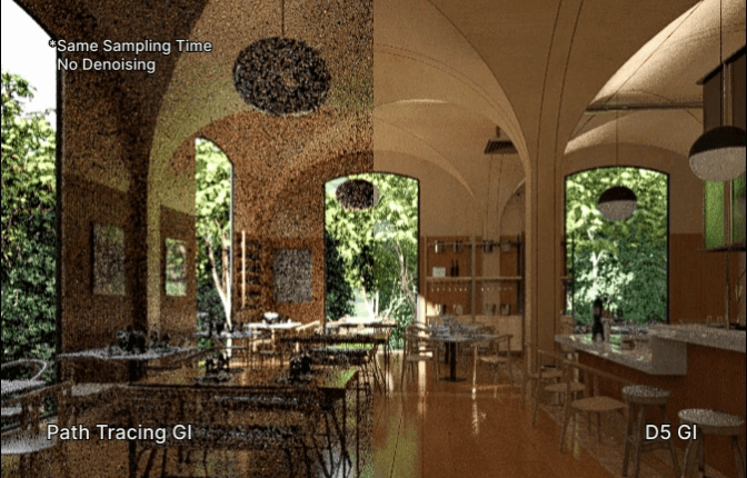

I recommend everyone to read our blog to learn more about path tracing and D5 GI.
We do more work than path tracing. :eyes:
